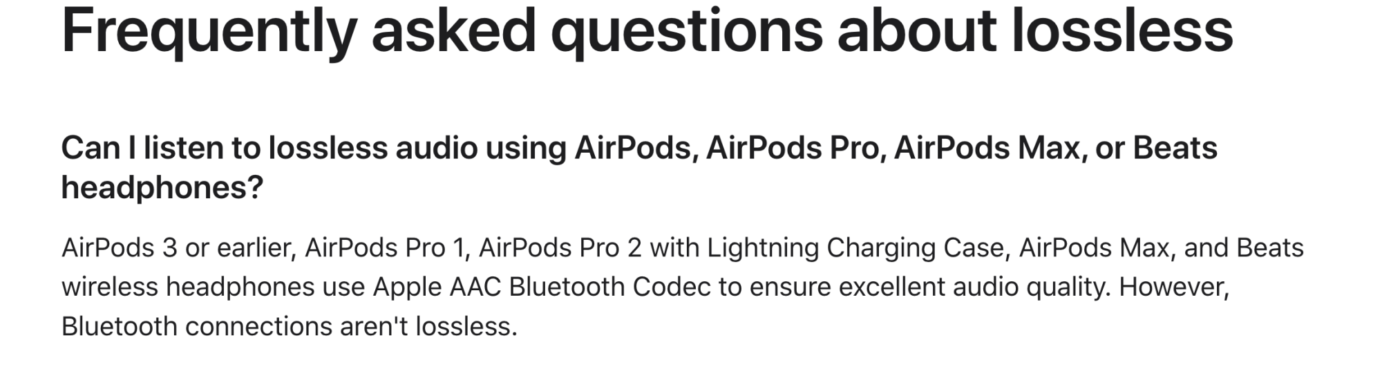

I purchased the AirPods Max with USB-C the other day and so far am very satisfied with them.
However, it's not really clear to me whether they support lossless ALAC when they are connected with the supplied USB-C cable to my Mac that plays Apple Music with quality set to "Losless ALAC up to 24-bit/48kHz" in the settings.
There's a support article that hasn't been updated for the USB-C version:
According to that article, lossless is not supported when using the AirPods Max in Bluetooth mode although music will still play fine but will be down-converted to AAC 256 kbps before being transmitted to the AirPods Max. All that makes sense and is expected. The first generation supports a lightning to 3.5 mm headphone jack cable and according to the above article, this means lossless is kinda supported but with the caveat that there's an unnecessary ADC step.
Now, with the USB-C cable directly connected to the Mac and to the AirPods Max, there shouldn't be any unnecessary DAC-ADC step and lossless should be really lossless. But I'm wondering if that's confirmed and stated anywhere? I can't find any information on the Internet.
To complicate things further, the Apple Music app on the Mac always shows the lossless icon, regardless of whether I use the AirPods Max cabled or wireless. I think I can hear an improvement when I connect the cable but since lossy AAC 256 is already good enough to be indistinguishable to lossless for most people and situations, I may be making it up 😀 I'm just wondering if it's OK for peace of mind to enable lossless, so that highest quality is being used or it's not worth it? Please, let's not argue whether lossless is worth it compared to lossy. My question is a concrete one: if the USB-C cable transfers lossless ALAC to the AirPods Max.

No.
It's AAC even when connected. This was not updated even with the "new colors" USB-C. It's why the support document hasn't been updated, it doesn't need to be, no "Airpods Max" product supports lossless and therefore the wording is still perfectly valid.
