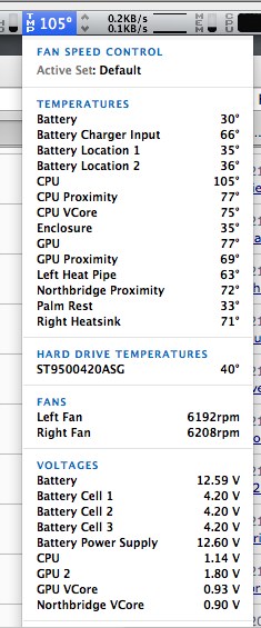

Oops, It looks like shutdown imminent for me then ....
