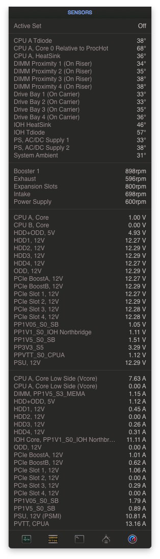

Anyway, just made some screen captures @ room temperature 25C
Stabilized at idle. PSU 1 (PSU Ambient) = System Ambient, PCIe Ambient =35
5min after Handbrake + FCPX rendering. So, my W3690 and 2x7950 are all under real world loading.
PSU 1 = System Ambient -1 = PSU 1 (idle) +1, PCIe Ambient =42

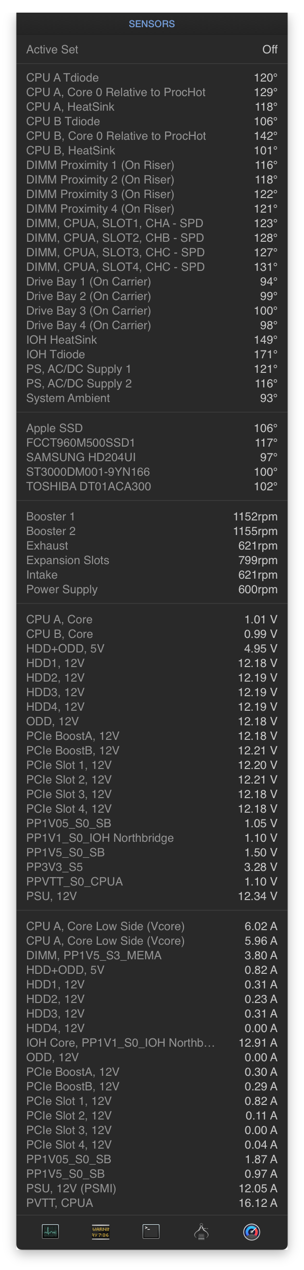

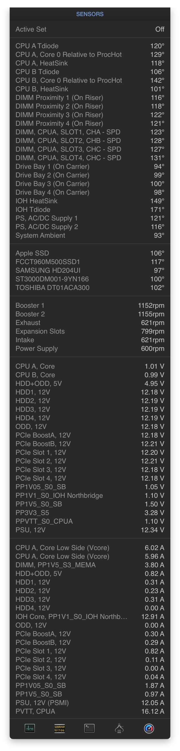

10 min after Geekbench stress test + Open CL Nbody simulation (multi cores) + Luxmark 3.1 GPUs stress test.
PSU 1 = System Ambient -2 = PSU 1 (idle) +2, PCIe Ambient =46
So, even the load increase a lot (PSU output from 10A increased to 35.2A), and the PCIe Ambient goes up for 11C. The PSU 1 and System Ambient still roughly the same temperature. Of course, the PSU fan spin up to cool down the PSU a bit, but my own setting should actually make it run slower than the native setting (under loading). In case anyone interested, here is my PSU and PCIe fan setting.

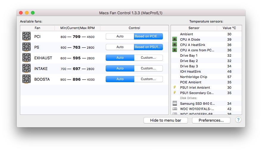

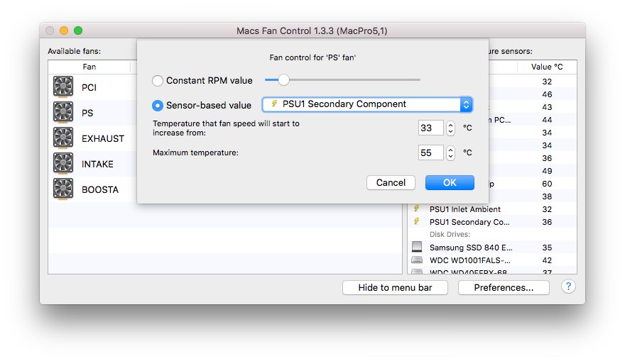

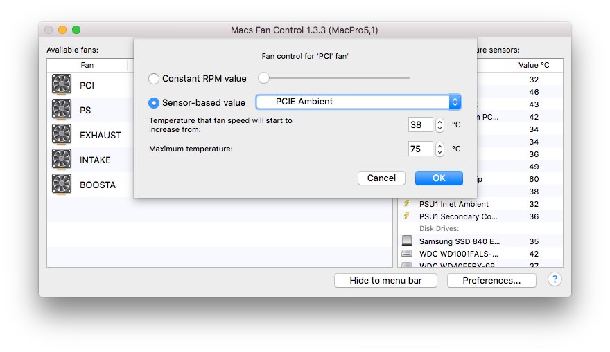

Your power supply fan seems to spin at a higher RPM than mine at idle. Our ambient temp is about the same.
Yes, because I make my own PSU fan profile, which is based on the PSU 2 temperature. I found that the native PSU fan speed is not based on the real PSU temperature, but more like base on the PCIe booster cable's loading. I am not happy with that, so I modify it via Macsfancontrol. Which gives me a cooler PSU in most of the time, and less PSU fan noise under high GPU loading.
If I let it back to the stock 600 RPM idle, the PSU ambient will be stable at 2C above system ambient during idle. It's a bit higher, but insignificant.
