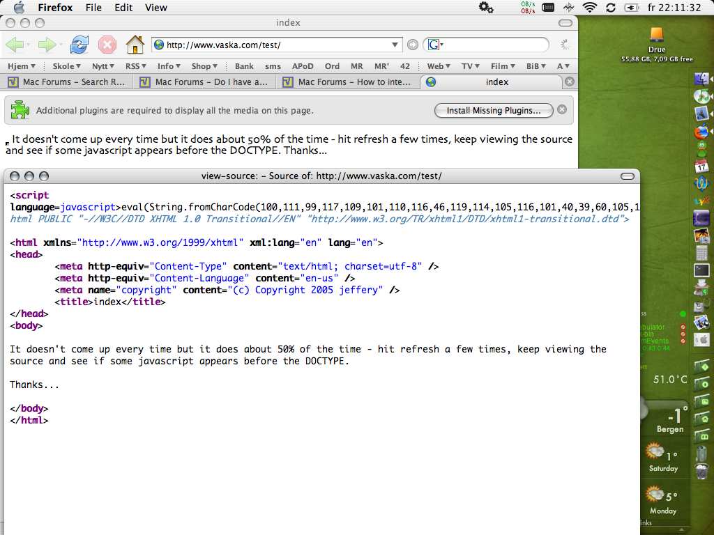

Well we can rule out your ISP, and if that file was "clean" when leaving your computer, it's back to your webhost...
Came up on first try, and since it's added to the top of the file I really suspect something added server side...

It came up once for me and I am 99% sure it had to do w/ me being on Windows but the second it fully loaded I needed to reboot - firefox froze up and internet went down...
Its your WEB HOST
I went to http://server145.ezbudgethosting.com (machine where your site is hosted, BTW)
Up came our friend - notice the first line in the source.

Nice catch... I think we have a winner...!
jvaska, if your webhost doubts it just give them a link to that... and give 'em a good yelling for letting us run through hoops all day for nothing, as they were the initial suspects... 😉
