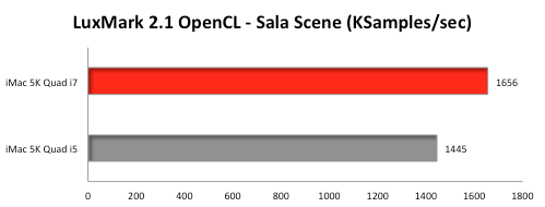

For Final Cut Pro X this benchmark is interessting:
We rendered the Sala scene using GPUs only. The R9 295X GPU in the Quad-Core i7 displays a 15% advantage.
Final Cut Pro X will offload as much as it can to the GPU, but not everything can be handled by your GPU (we wouldn't have CPUs anymore if that would be true, right?).
So if it's okay for you and your money, go with M295X + i7, otherwise M295X + i5. But please don't to M290 + i5 for your usage pattern.
