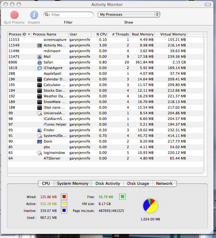

The computer is on 24/7 with putting the monitor to sleep at night. The only time I shut down is when I will be gone for more then 1 night.
Attached is a picture form the activity monitor? Any thoughts?

clevin, what are you talking about? The OP's PageOuts are as high as their PageIns. No matter whether you think their application load should be under 1 Gb, the evidence is that they are regularly exceeding the physical memory.
eyedoc:
Your PageOuts should be under 10% of your PageIns, even better under 5%
Yours are at almost 100%. Whatever it is you are doing with your machine, it's causing massive swapping to the hard drive because you are exceeding your RAM. Another 1 Gb module would be a good investment.

Safari is taking a lot more memory then it should. It is pulling 2 gb of VM and that is why you are slowing down.

Safari may take large chunks of RAM like that if you are using sites that use AJAX like the Forum Spy. Sometimes though Safari's ram usage will just go up and up if you've had it open for a few days. I would just quit and relaunch Safari when you start noticing a problem.
Pageouts or not, 1 Gb should be plenty for the things you are doing. More than plenty. Though I can't help but think Apple is abusing the ram usage lately. iTunes shouldn't take up that much ram just to play music.

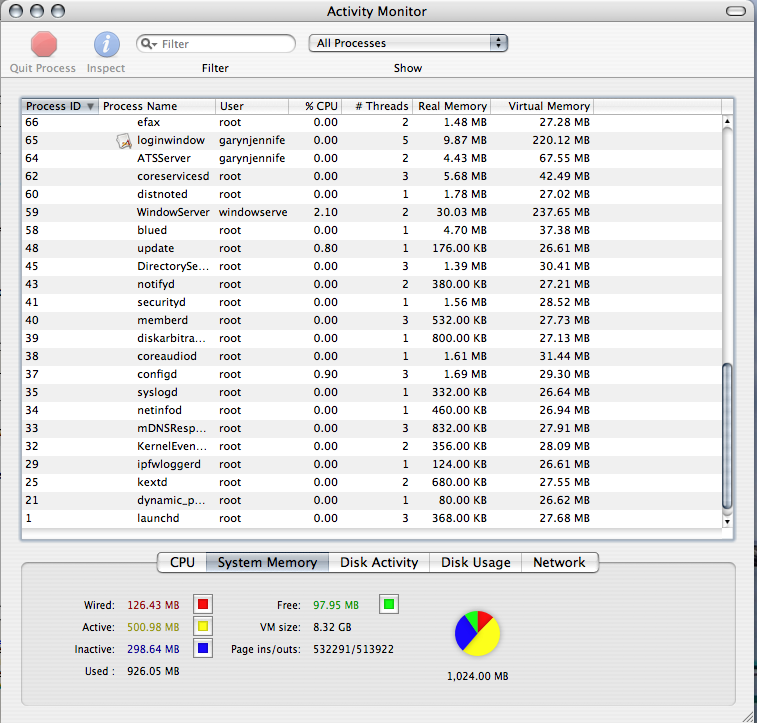

Take a screen of ALL processes in the activity monitor, there are a lot of things that run as root or windowserver that could be eating memory too.
Also .. widgets are HUGE memory hogs, if you use them OK, but if you don't, then remove them from Dashboard.

I did post a screen shot of all the processes a little earlier in the thread.

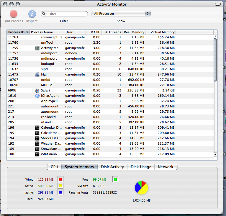

Not quite, look at the dropdown at the top, it's only showing "my processes" there's an option for "all processes" that shows you things that are owned by the system.
Sorry. attached are all the processes.

Safari notoriously leaks memory, and will consume more the longer you use it.
The latest development versions of Safari (called WebKit) fix a large number of these leaks, but they are still there...
I recomment using WebKit, a different web browser, of keep tabs on Safari's memory usage, quitting and relaunching it when it gets high.

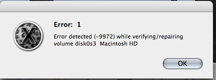

Ok. installed OnyX. First, when it asked to verify start up volume it comes up with the following error.
Second, I ran all the maintenance steps and cleaned all the caches. I also restarted the computer twice. That freed up a lot of memory. I will now see how long this lasts.
