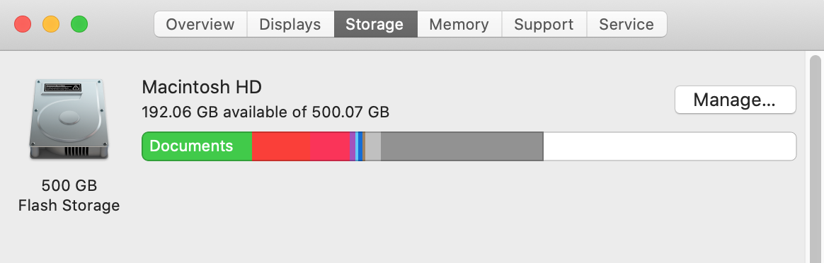

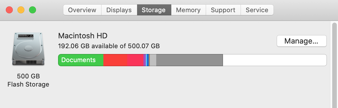

1. Firstly check your much free hard disk space you have.
Click on the  icon in the top left part of the screen. Select 'About this Mac' and the select the Storage Tab. As a rough guide you should allow 10% as free space. When you are running multiple programs you Mac will use some of this space when you run out of Ram. As the amount of free disk space reduces below what it needs it can significantly effect performance.

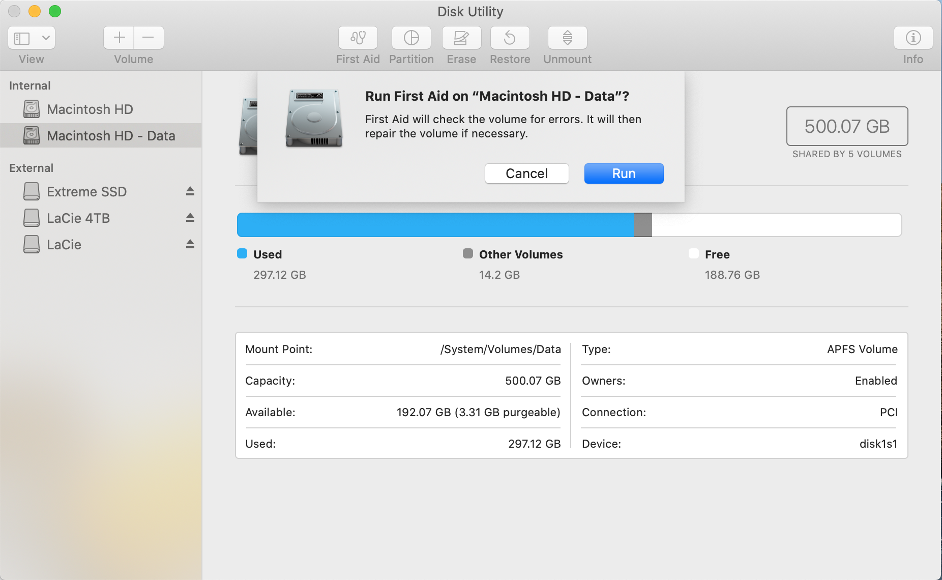

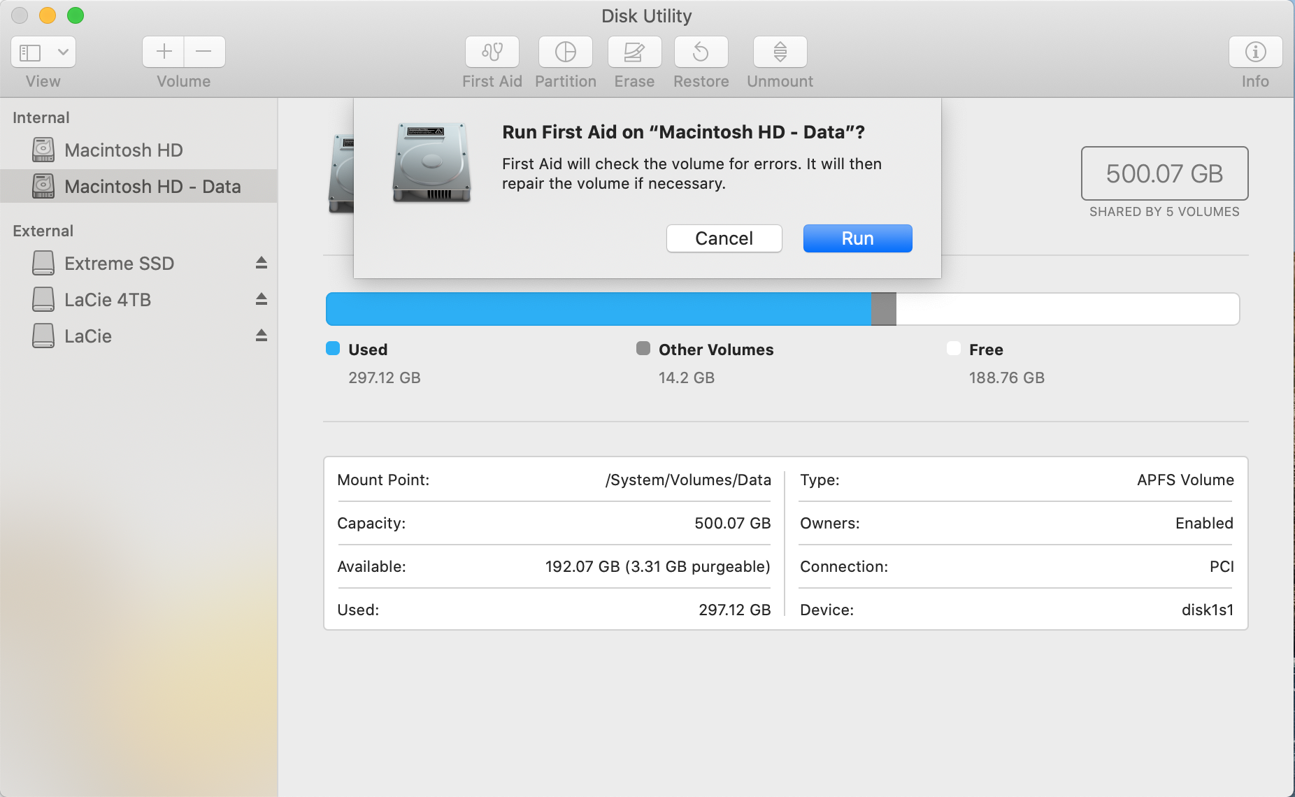

2. It is possible you have some issues with your system disk.
Your Mac has an in-built tool called Disk Utility. Open this program ( Just Click the spotlight icon and enter Disk Utility - the App should be highlighted and press return to run) and select the hard drive in the panel on the left. In the main panel, click Run First Aid. The program will begin checking your hard drive.

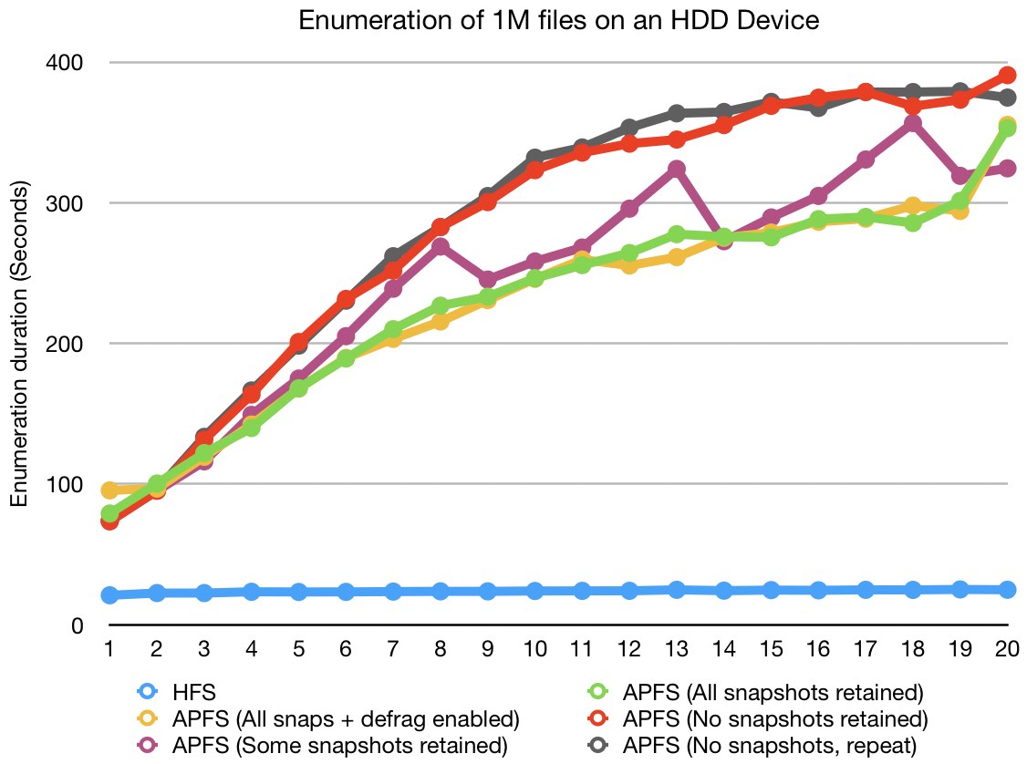

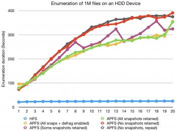

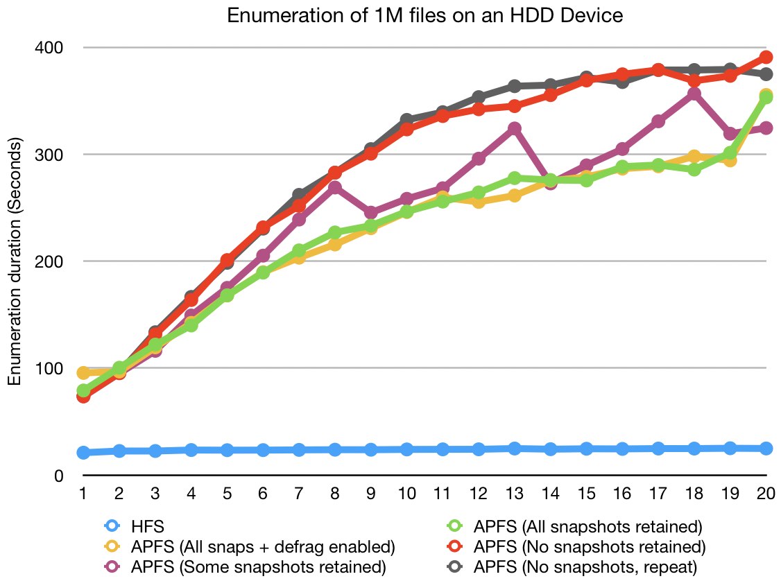

The issues of Catalina and APFS on HDDs isn't just on the MR forum, but everywhere. Just do a something search and look at all the results of actual tests. Here are the first few that popped up for me:
True, there could be all sorts of other factors, but it would be hard to deny that an addition to a SSD would make the overall performance seem better.
This is from a test from the first link I posted showing enumeration performance of HDDs comparing HFS and APFS, the blue line is from HFS, and the rest is from APFS:
If you read the newer articles, it appears that the HDD performance has only decreased since Catalina, not improved.
