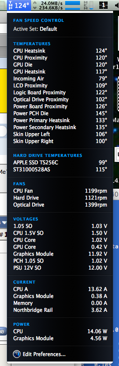

bjango has an app called istat menus for any idevice , i love it

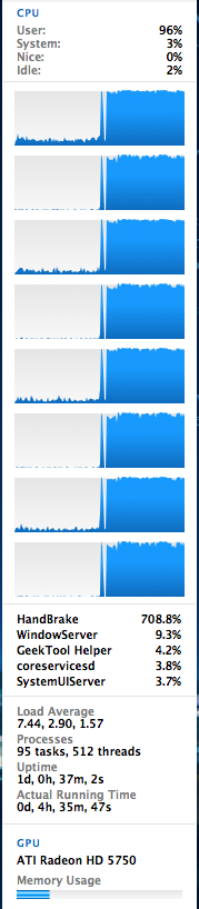

I'll toss my experience in here as well. I've never had any heat issues with my 2 iMac's. This screen shot is of my 2.93GHz i7 ripping a DVD with Handbrake. As you can see, the cores are fully maxed out and I ripped about 10 DVD's that particular day and never had any issues at all. Yes the iMac heated up, which is expected, but it wasn't a problem.
Totally off topic, but how long did it take to rip a DVD w/ Handbrake on your i7? Looking forward to getting my first quadcore 😉
It was amazingly fast. I took a homemade (honestly) DVD of about 2.5 hours in length and the i7 ripped it in under 13 minutes.
A typical movie DVD rip on my 2009 i7 is usually less than 15 minutes. Which is amazing considering it would take 15-20 minutes to rip a typical music CD on my Pentium computer back in 2000.
