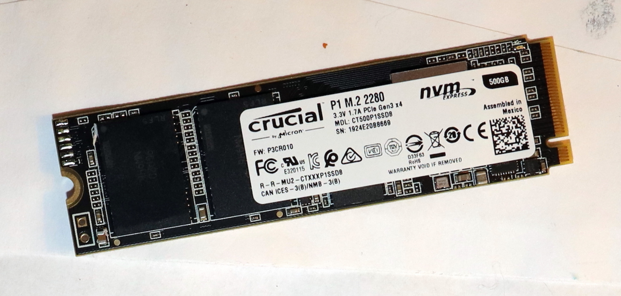

Here's the drive as it comes out of the package:

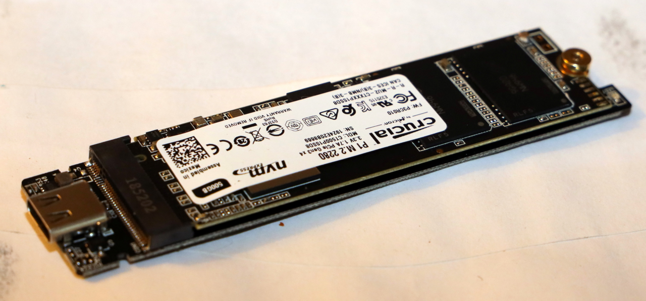

The drive mounts to the controller board, and is secured with a retainer and screw:
The case cover slides on and is intended to be secured with a screw. But since the cover stays in place nicely by itself, I left the screw in the box for now.

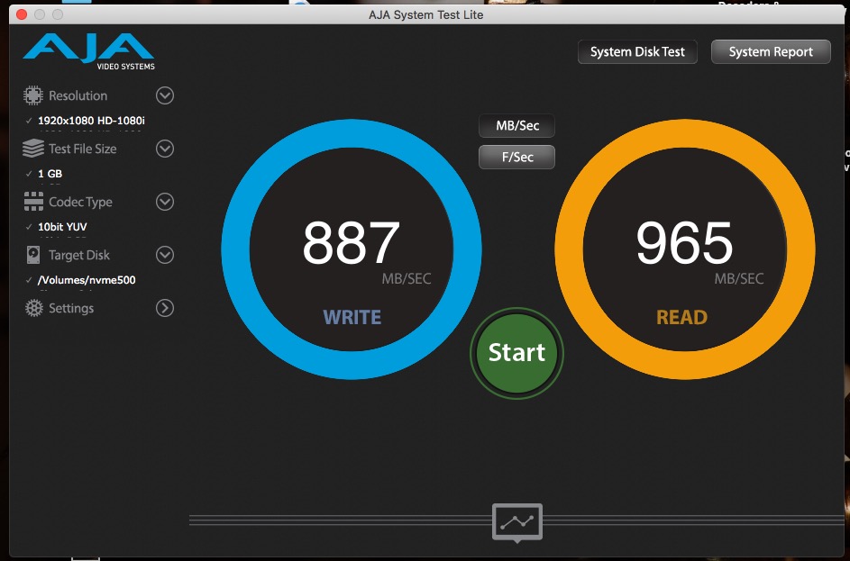

Then I ran a speed test with AJA System Test Lite:
I discovered that the enclosure/drive I have runs quite warm, even when "just idling" (connected with no data moving in either direction).
