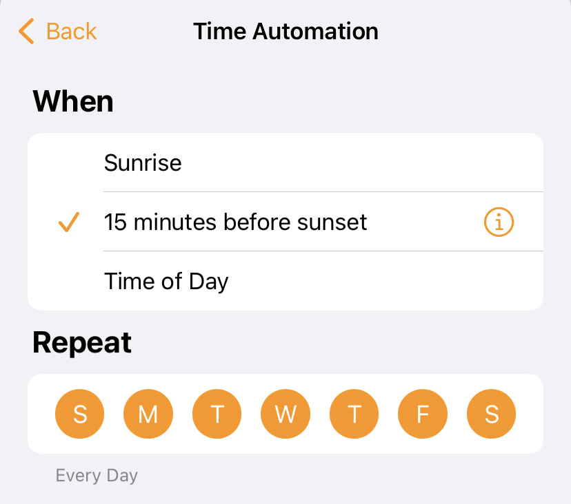

I definitely haven’t seen many light sensors, are you using HomeKit with your devices?
If so I use the sunset automation and it works perfectly and adjusts automatically with time changes.

Sadly, the Apple Home app Sunset automation is not that good. It can for obvious reasons not take into account things like cloudy days and passing rain clouds etc. :(

Thanks guys. So the sonsors exist, but Apple's HomeKit is not smart enough to use it, and you have to use extra apps for it. :( Well, I will look into it and try.
