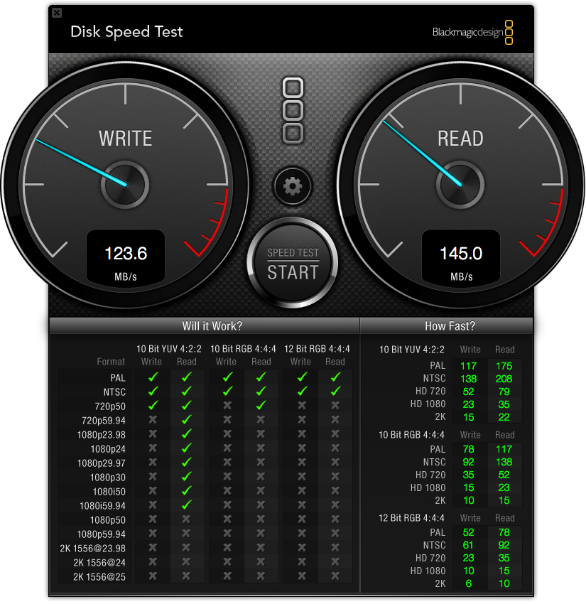

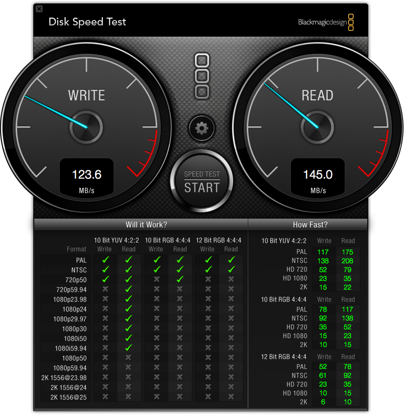

My 2011 has slowed down since I bought it, and yes its a Toshiba.
I'm pretty sure it was around 180 for the read speed when I first got it.
However it doesn't feel any slower, or maybe its been slowing down so slowly I can't really tell.
