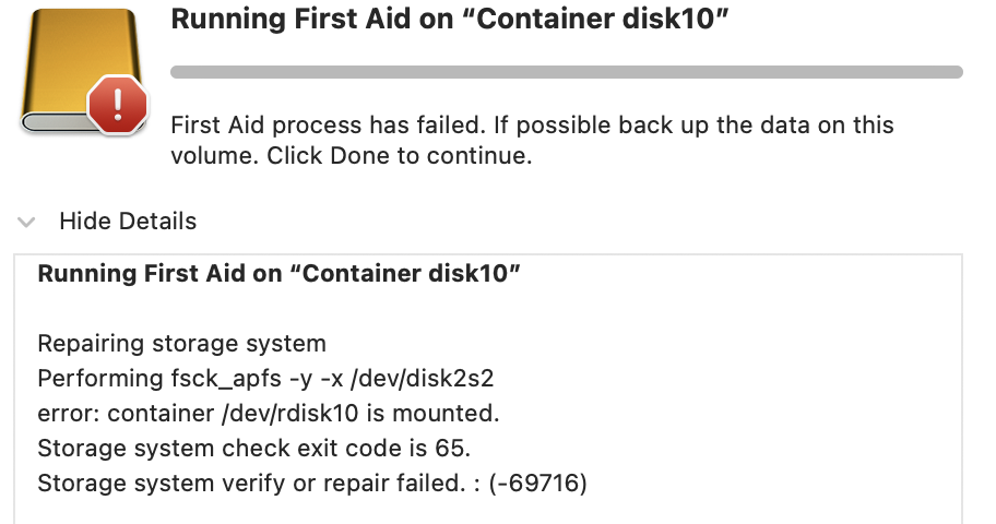

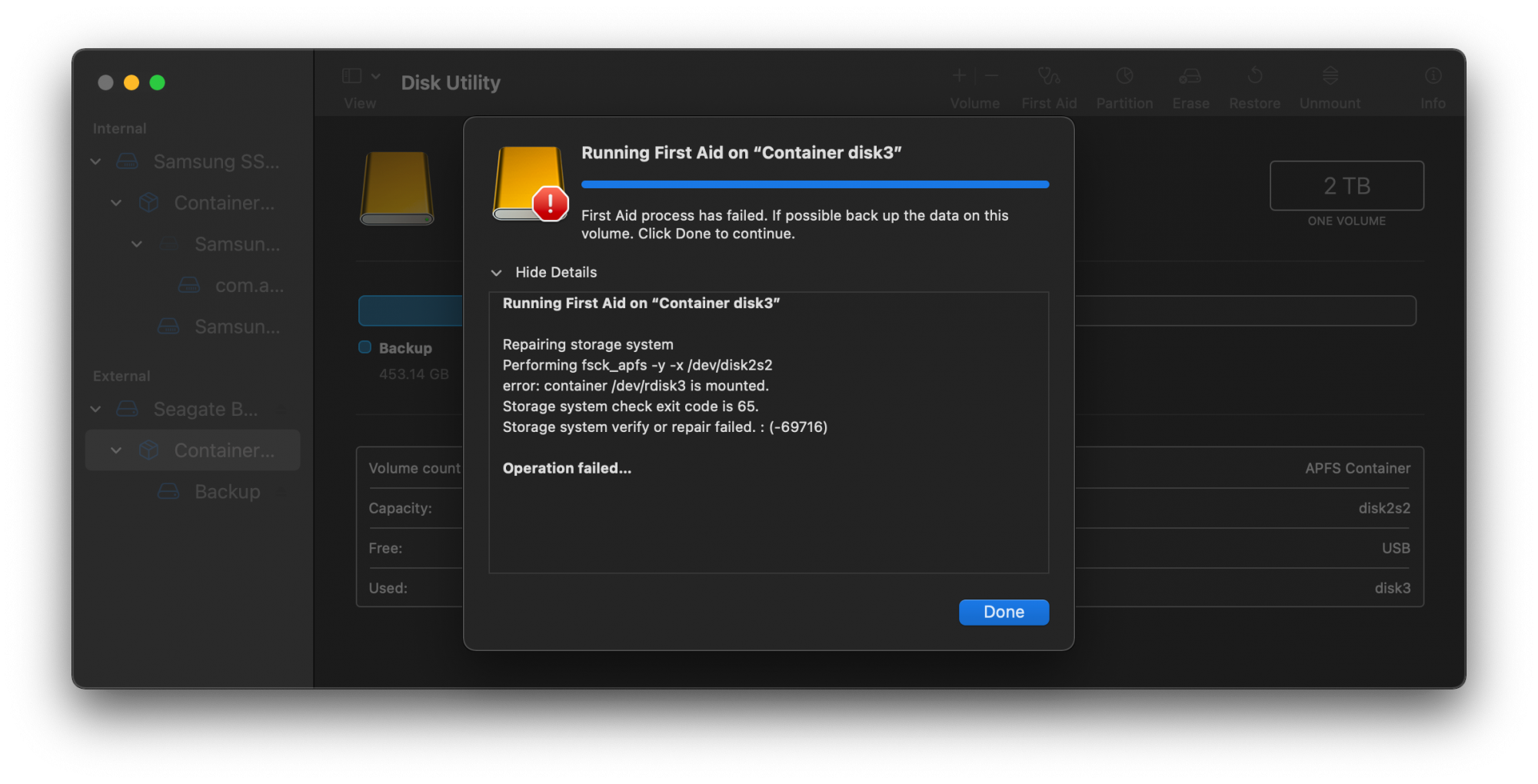

Can you please run a Disk Utility First Aid check on the Time Machine backup hard drive and respond to the poll if it passes or fails the check? This is for users of Big Sur 11.5.2 and you use spinning disk hard drive(s) for TM backups. Please also indicate the type of Mac you have (e.g., 2013 Mac Pro, 2019 Mac Mini, etc.) Please do not respond if you run a different version of MacOS or you use SSD for backup.
Ever since I updated the MacOS to Big Sur 11.5.2 on my 2013 Mac Pro (Trashcan), I have run into this issue. I have tried 3 HDs and they all failed. They are directly connected to my Mac Pro. The error message looks like below:

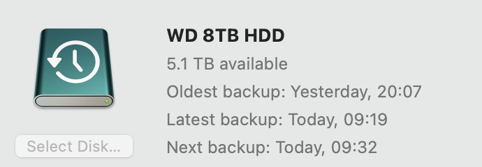

The only thing I keep finding is mysteriously skipped Time Machine backups. I used TimeMachineEditor to tweak the settings so I only do two backups a day and every once in a while it just seems to silently fail.
No other issues with ejected devices, though.

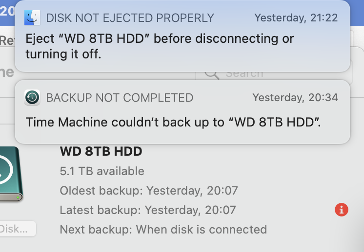

Update from my latest experiment"
Full TM backup completed
Subsequent TM backup failed
Then a eject disk error occurs
I reconnect the hard drive and FirstAid fails
I start TM backup and it completes
While typing this, I plug the HDD back in and run FirstAid again, failure
At least there seems to be consistency with FirstAid this time

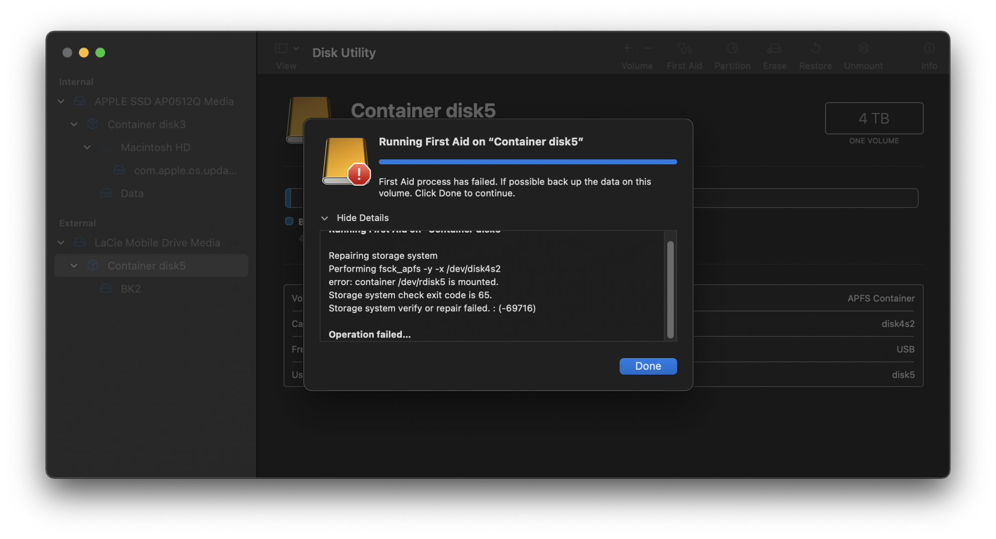

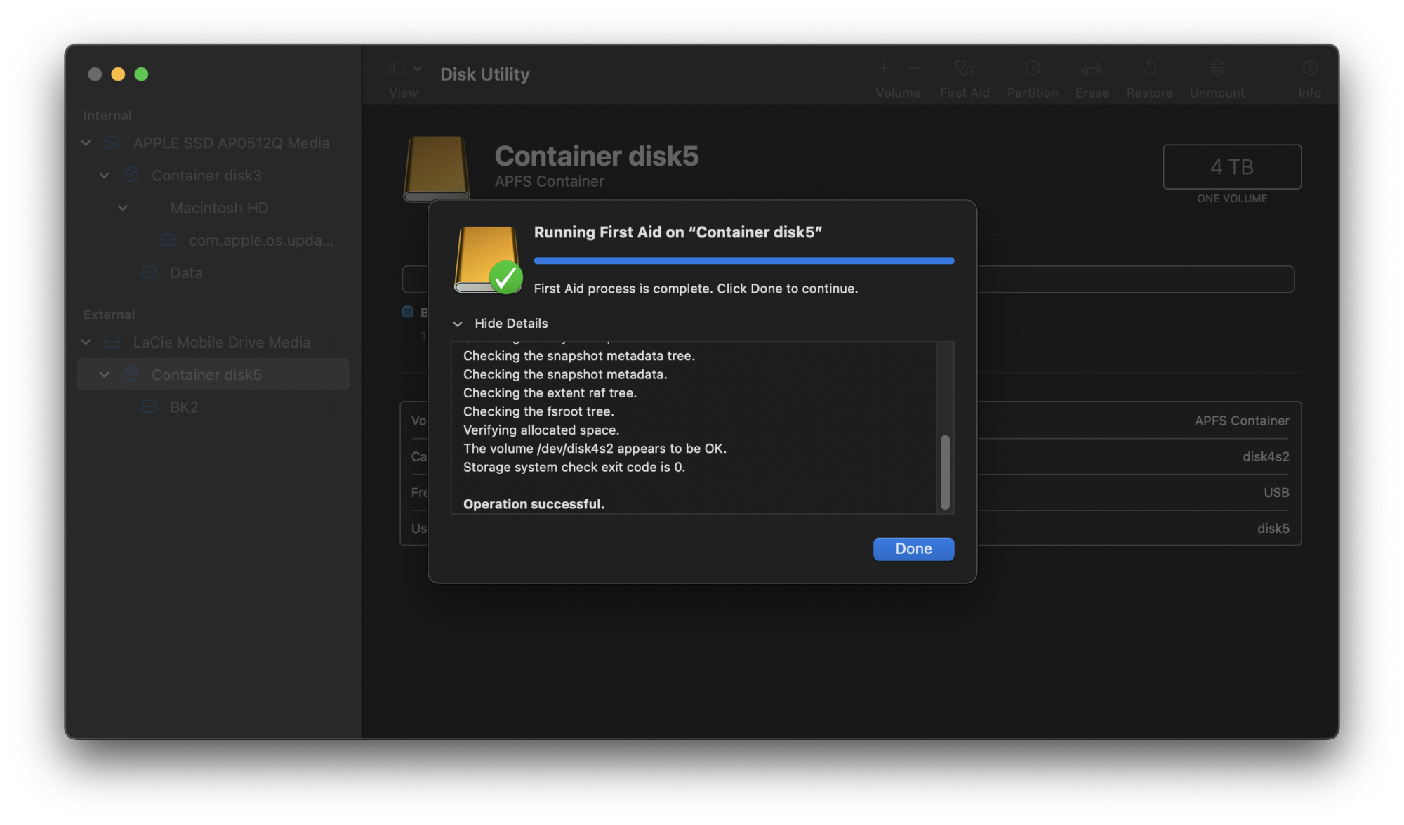

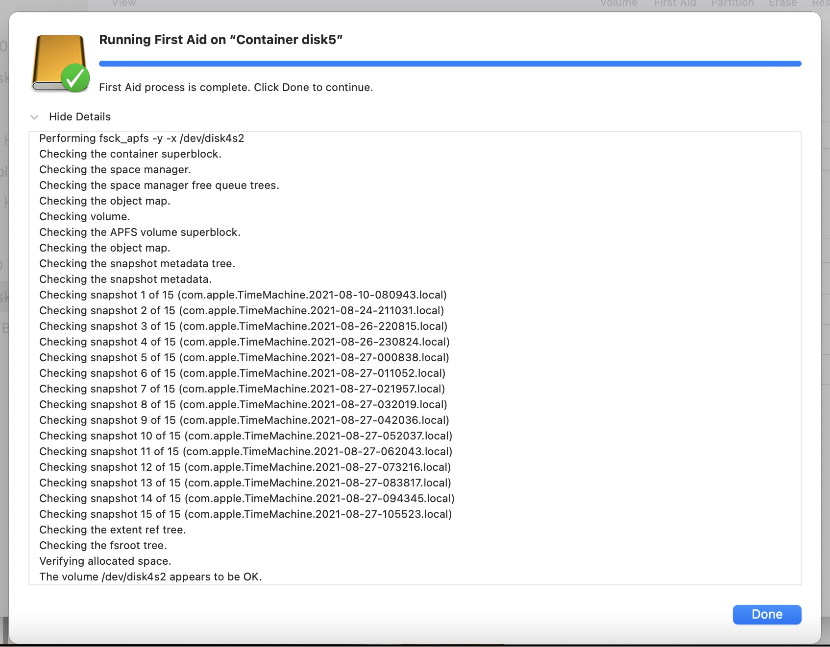

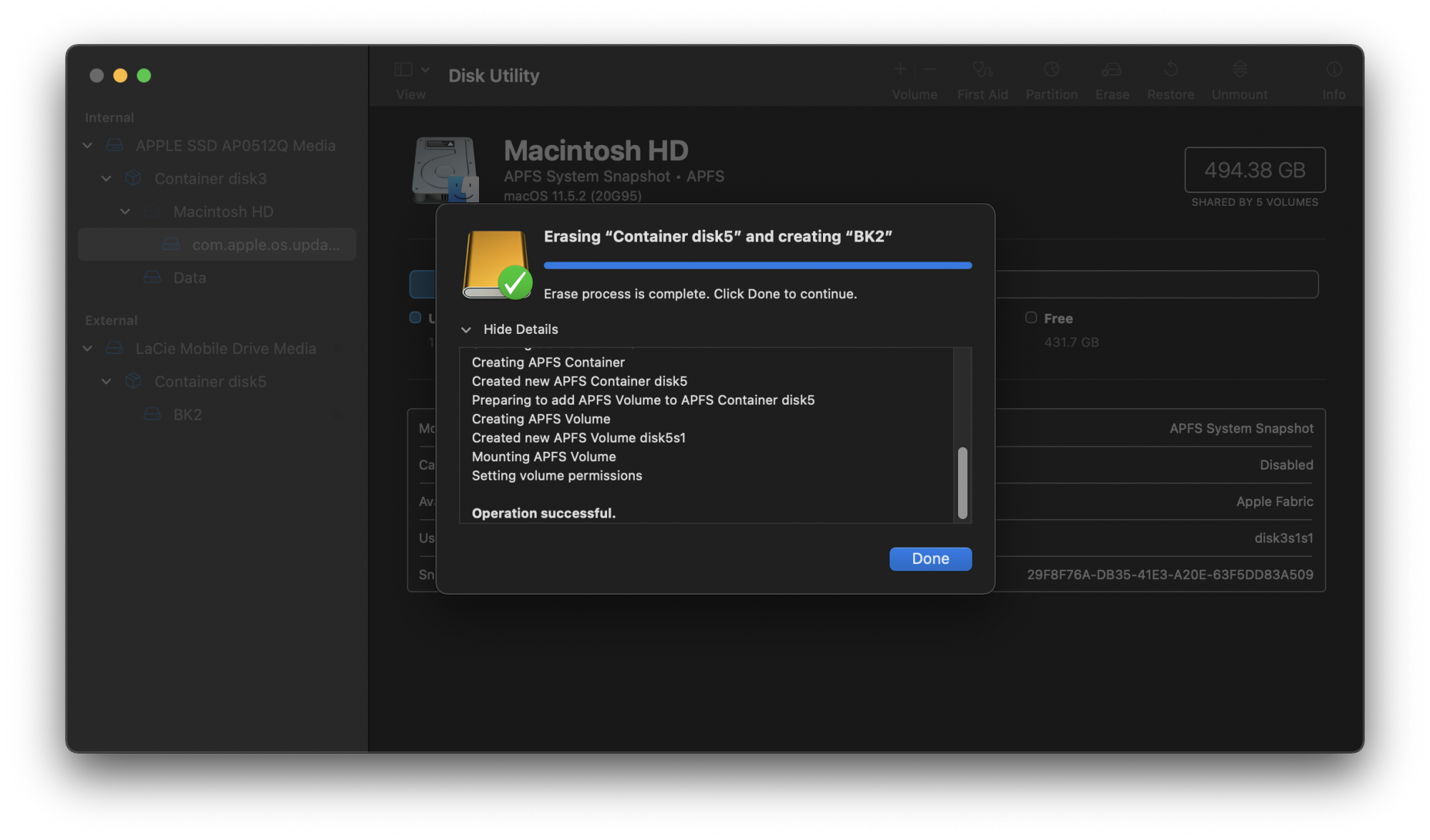

Let's know how it goes. I am doing another experiment as well. Instead of my 2013 Mac Pro, I am now testing it on my M1 MBP. This M1 MBP also runs Big Sur 11.5.2.
I erased and reformatted the same LaCie drive with APFS on the M1 MBP. Then I ran First Aid on it and it passed too. Now it is backing up the M1 MBP with Time Machine. Will run First Aid again.
Update: My M1 MBP has no problem at all with the APFS formatted external HDD. This HDD failed on my 2013 MP. I moved the HDD to M1 MBP, erased it, reformatted it to APFS, tested it with First Aid and passed, ran TM backup, and then ran First Aid again. It all works.
My next test is on my 2019 MBP....
Screenshots from M1 MBP:
Reactions: jz0309

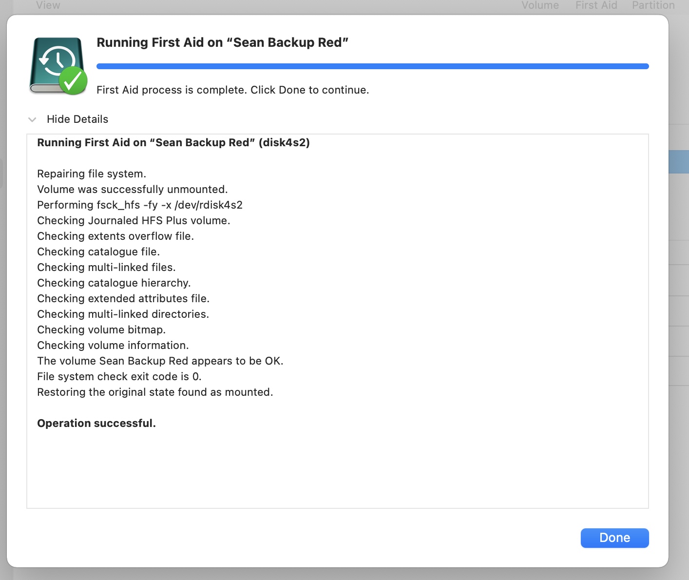

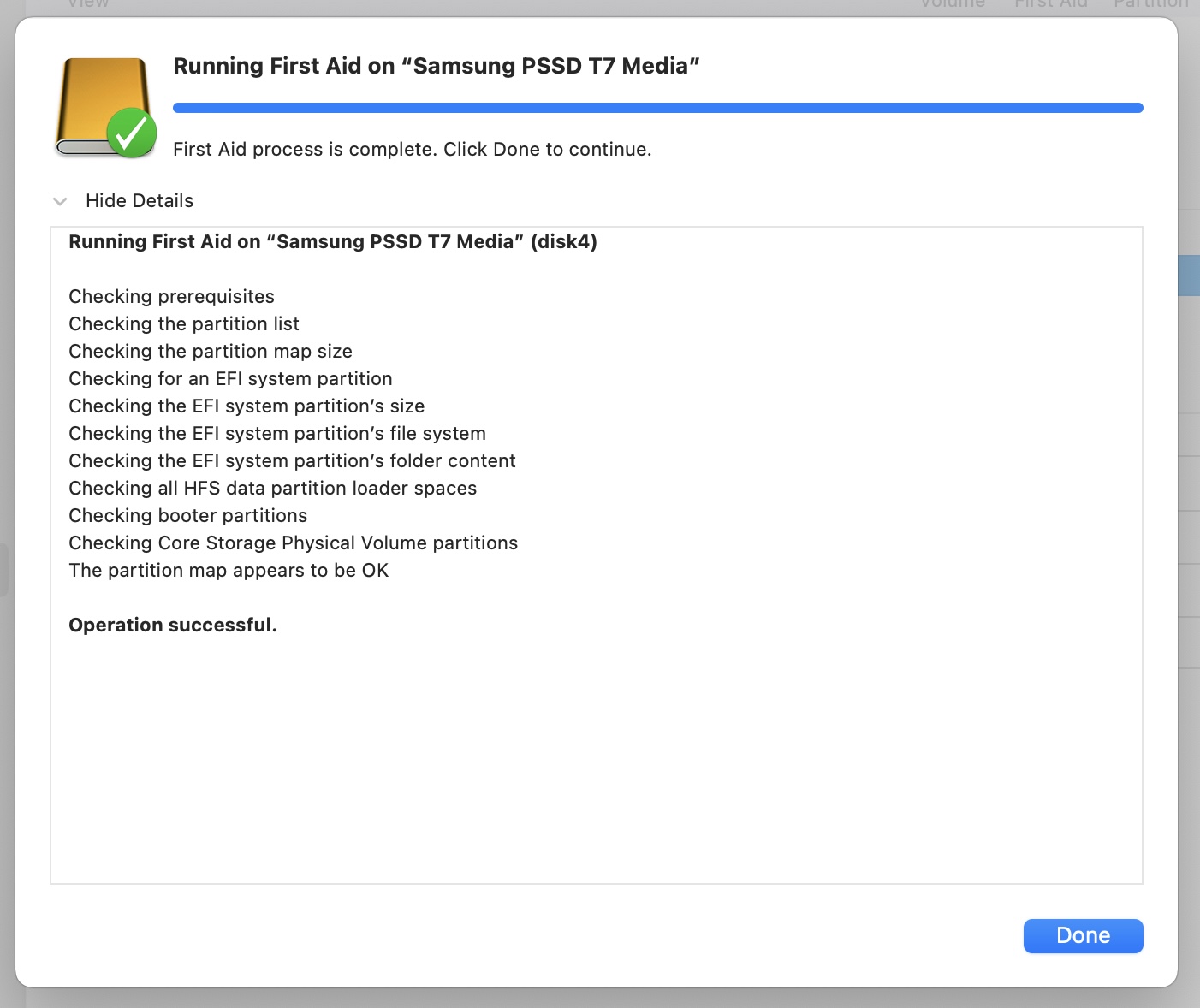

But to answer the original question; No TM backup disk problems on Big Sur 11.5.2, on an M1 Air.
However, I have a Samsung SSD T7 external formatted to APFS which contains my 700GB / 105k image Photos library, it is lightning fast, no problems. Then using Time Machine, I back that drive up to my regular 5TB Seagate HDD which is formatted mac os journaled (HFS+). Again, no problems.
This is my Seagate 5TB HDD, format HFS+:
This is my external Samsung T7 SSD, format APFS:
