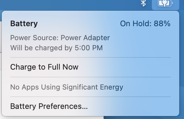

Here you go, @Apple_Robert says trust the software. He isn't wrong.
It is 9am CT so laptop algorithms know I have enough for the day.
I have never seen that screen. My M1 MBA has had "optimise Battery charging" on from new and is plugged in most of the time. No daily routine to learn. After six weeks it dropped from 100 to 80% for about four hours than back to 100%. It repeated this a week later. These are the only "Optimise Battery Charging" events I have seen.

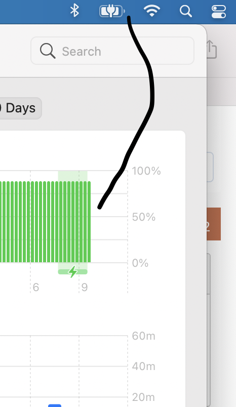

This morning was first I've seen. Instead of the lightening bolt over the battery, it shows an electrical plug (US Centric) I don't know x time before the optimized kicks in, but I suppose it is a month, I used mixed, some days charging while using some days battery all day.
Shows Charging on the graph, not on menu bar.

I don't really understand what Apple's strategy for optimized charing is. my Air is plugged in most of the time. Current usage is pretty light. the battery is always exactly 100%. Is there any time when the system will let it go down and stay there? I would almost never need 100% battery charge. I don't need it to guess when to charge to 100% as there is never a need for that. I would prefer if I could tell it to just never charge above 80%. then if I were to need more charge, I could go in and change it ahead of time.
As soon as I turned on Optimized Charging I started noticing that the battery of my MBP and my wife's MBP would dip to 80, 90, 85, randomly throughout the day, several times a day. Sometimes it sat at 86%, 90% for a bit, then charged back to 100%. I guess it kept the battery charged.
How long have you had the M1 MBA? And how long have you had optimized battery charging enabled?
I noticed that the first time it took about a month before my M1 MBA started to park at 80%. Then after a 11.2.x update it took another week to get back to where it was stopping charging at 80% again. But since then, it has worked pretty consistently.
I just told it to charge back to 100% because I want to see what the behavior is if I tell it to charge but then don't use it on battery for a day or so.
After six weeks on 100%, mine went down to 80% once for about four hours, then back to 100%. By eleven weeks it hadn't happened again, still 100%. At that point Al Dente was released and I have been using it since.
During the period it was 100% I did see very brief dips to 95%, but I never saw the option to "Charge to Full now" or the "On Hold xx%" message.

I've had it about 6 weeks, now. always set to optimized charging. It's almost always plugged in on my desk and I've never seen it below 100%. Once things open up more I'll probably spend more time away from my desk. maybe that will cause it to go lower or maybe cause it to try to keep it at 100%?
I think that Apple's strategy here makes me feel like I have less control. That is now how you should make your customers feel.

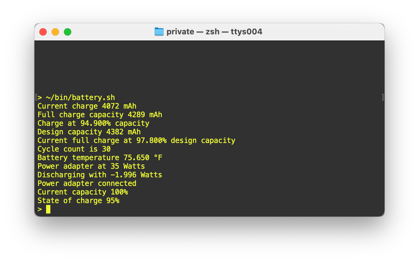

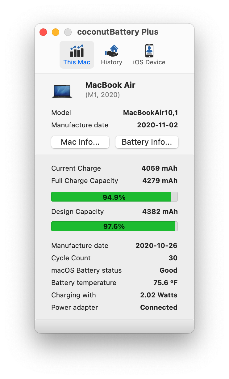

Right now mine is discharging at just under 2 W and is at 94.9%. This was after telling the battery to charge to 100% using the battery menu yesterday. Of course the battery menu extra still says 100% but that doesn't mean much. We'll see if it drops to 80% again and stays there. It looks like that is what the software is doing but it is still early in the process.
Edit: Interesting it looks like Coconut Battery has a bug. It claims the MacBook Air is charging when it is actually discharging. My command line tools seem more accurate.
View attachment 1754528View attachment 1754529

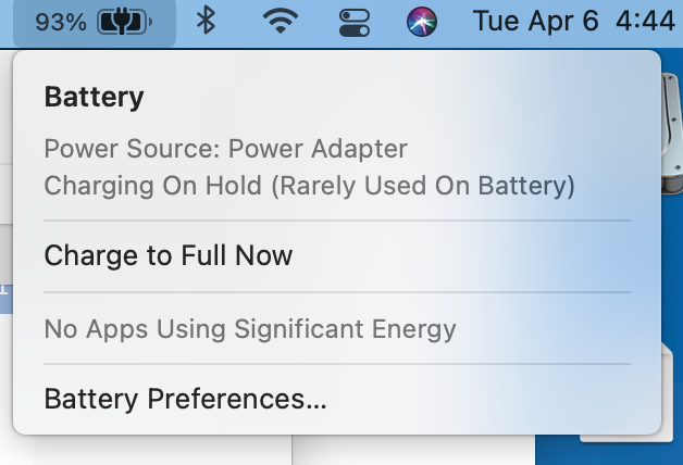

Another update. The battery menu extra is now showing 93% and the "not charging" power cord icon. The battery is still discharging at about 2 W and the charge is actually at 88% of capacity. So, optimizing battery charging is definitely working on my M1 MBA as expected.

Oooh that looks nice - did you get that .sh file from somewhere or program it yourself? If so, are you willing to share? 🙂
It uses a modified version of a command line tool called bitwise. I don't have a binary up on GitHub. If you are comfortable building software then it will work. If I have a chance I will put a binary version of bitwise in a release. The scripts are here: https://github.com/jamesdbailey/m1batterystats. The modified version of bitwise is here: https://github.com/jamesdbailey/bitwise.
What is shown here is a single script called battery.sh.
Thank you! Much appreciated! I know how to build code on Windows - time for me to learn on Mac 😀
Bitwise is a command line build. It doesn't use Xcode directly. You need brew if you don't already have it installed. https://brew.sh. The README (Edit: the README in my bitwise fork)has the details of what you need to install. After that, run the bootstrap.sh script. Then ./configure then make. Should create the binary.
Edit: I forgot the exports are wrong for brew with an M1. They should now be:
