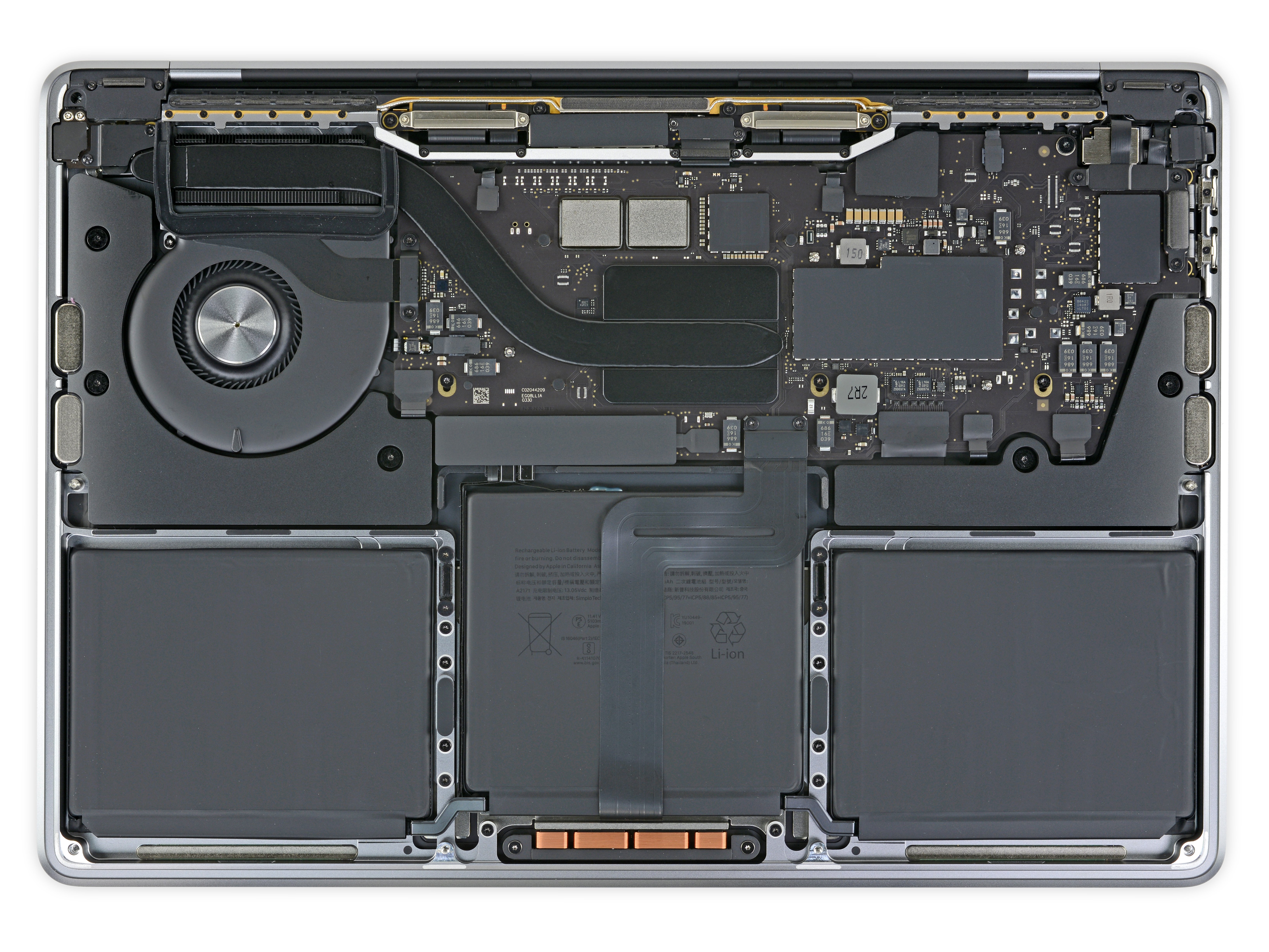

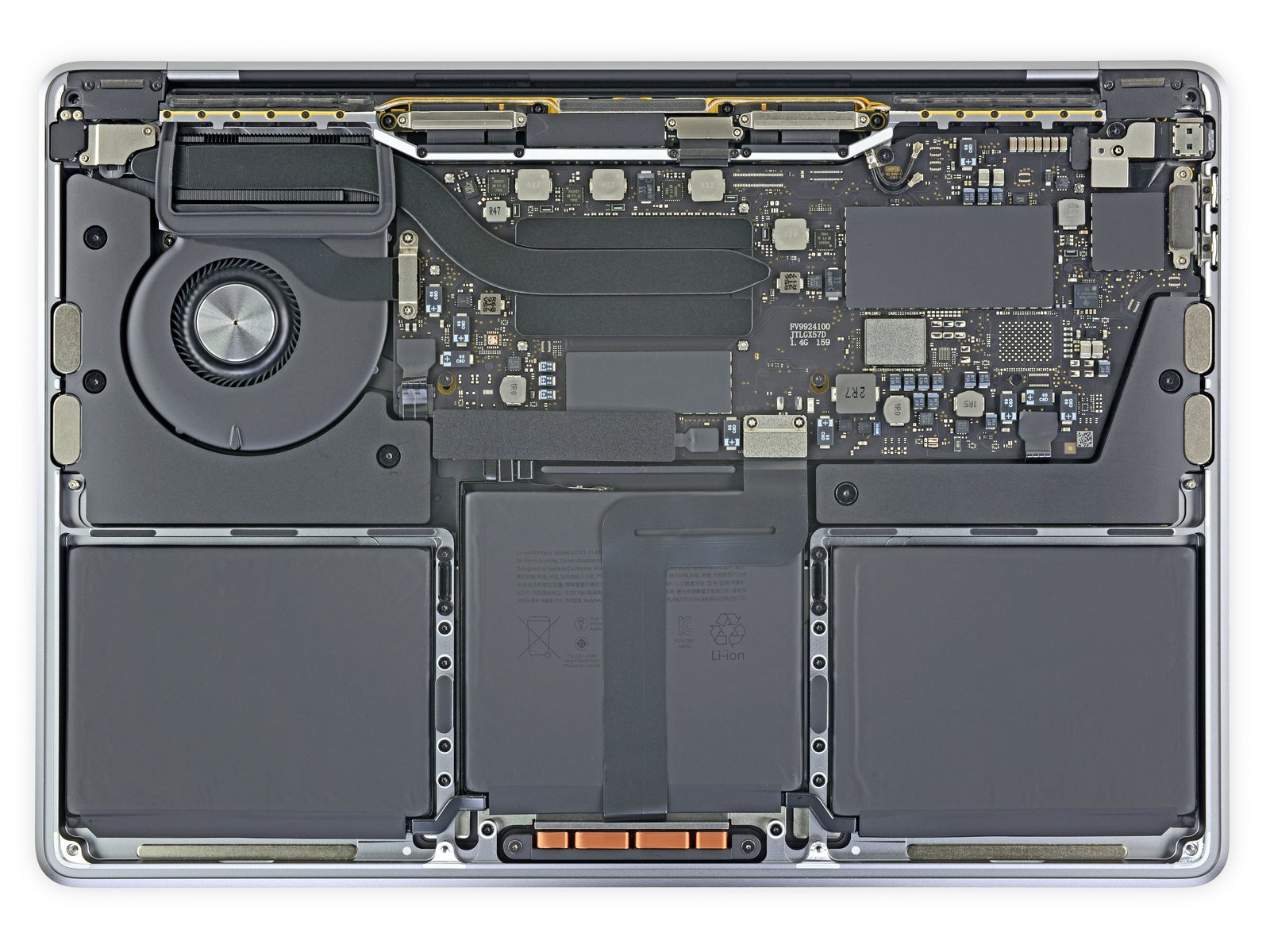

The Intel MacBook Pro 13":
3rcxn4P2WQpC4UaN.huge
The M1 MacBook Pro 13":
CKQtcJFiDAvNM2Pj.full

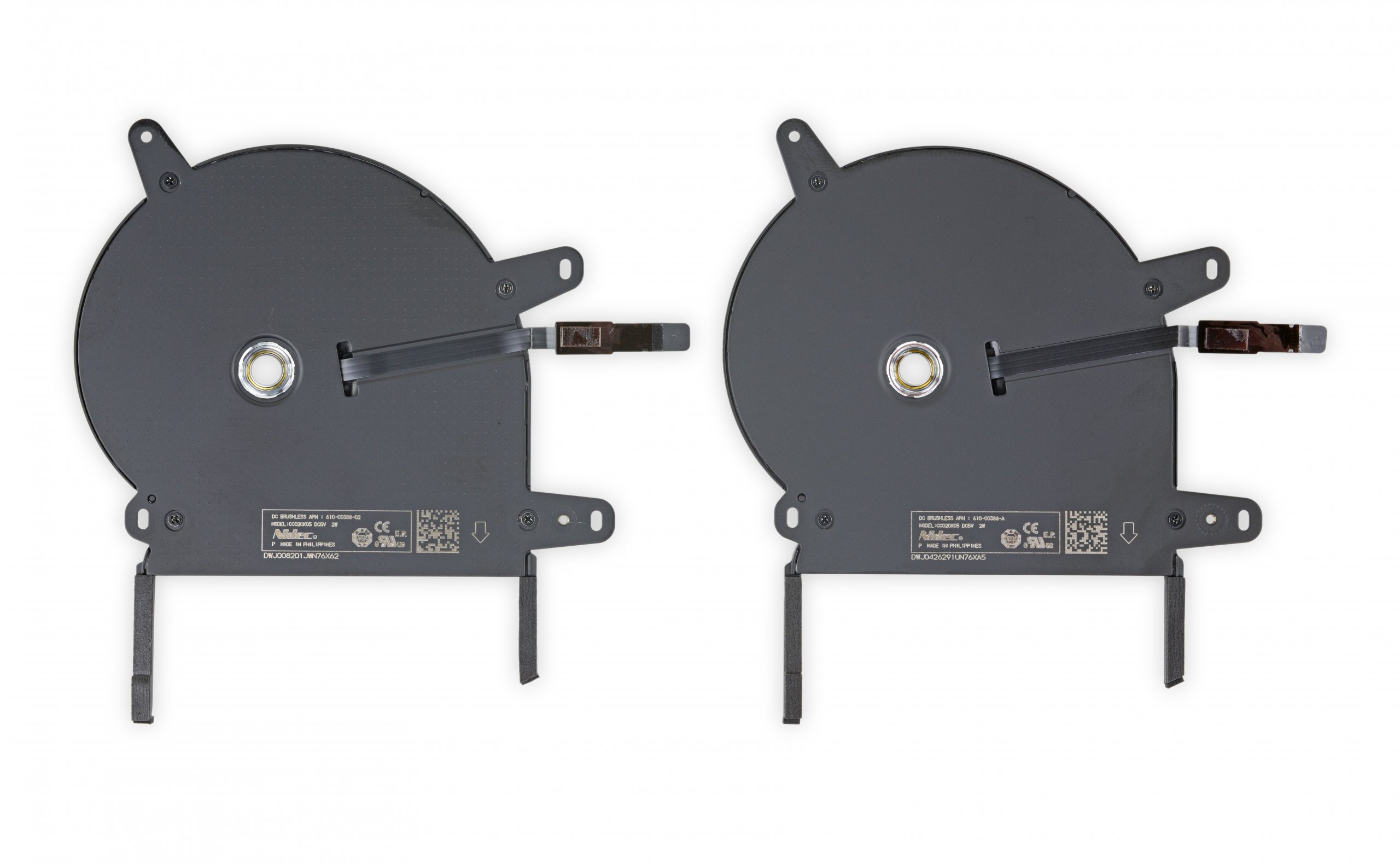

The fan is literally the exact same:

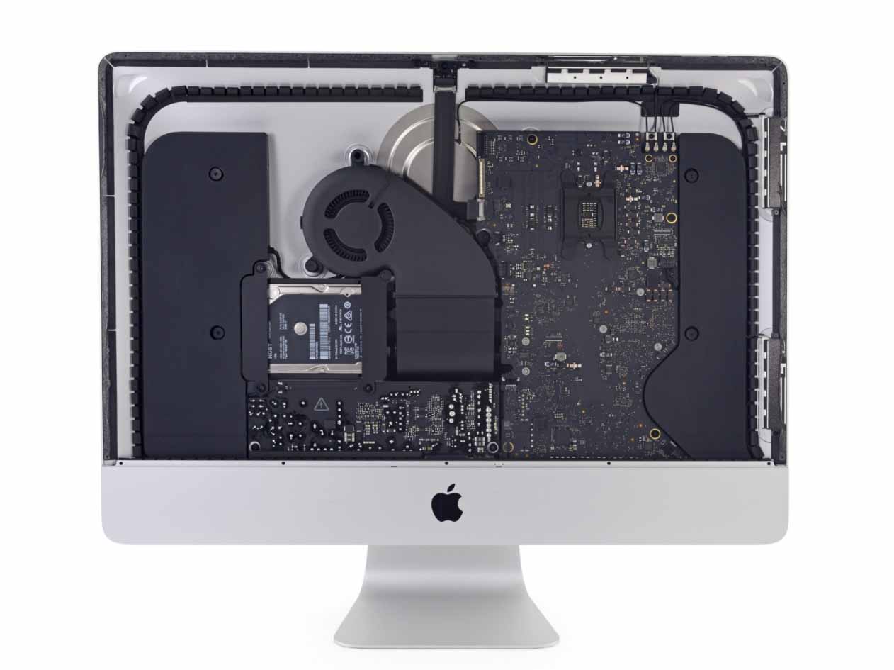

Cases can have a fairly significant effect on performance & thermals. Completely redesigned fans, placed in a completely different part of the casing that has access to much better airflow (right by the bottom air vents of the computer, compared to right behind the screen in the center of the computer) can as well. You'll find some tests where a different casing with better airflow can drop temperatures by over 20 degrees.
Intel 21.5" 4K iMac:
M1 24" 4.5K iMac:

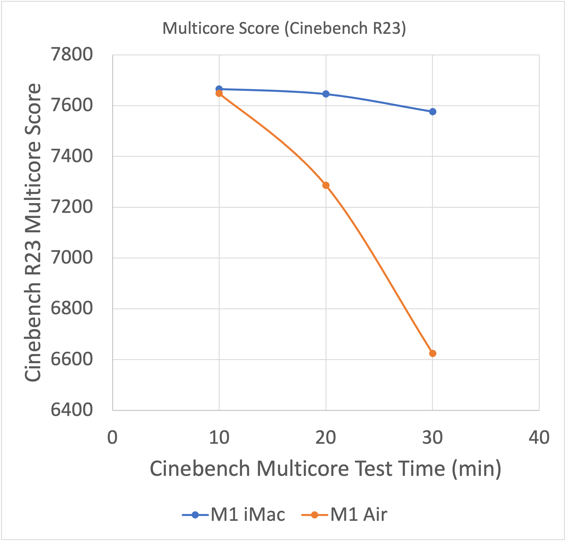

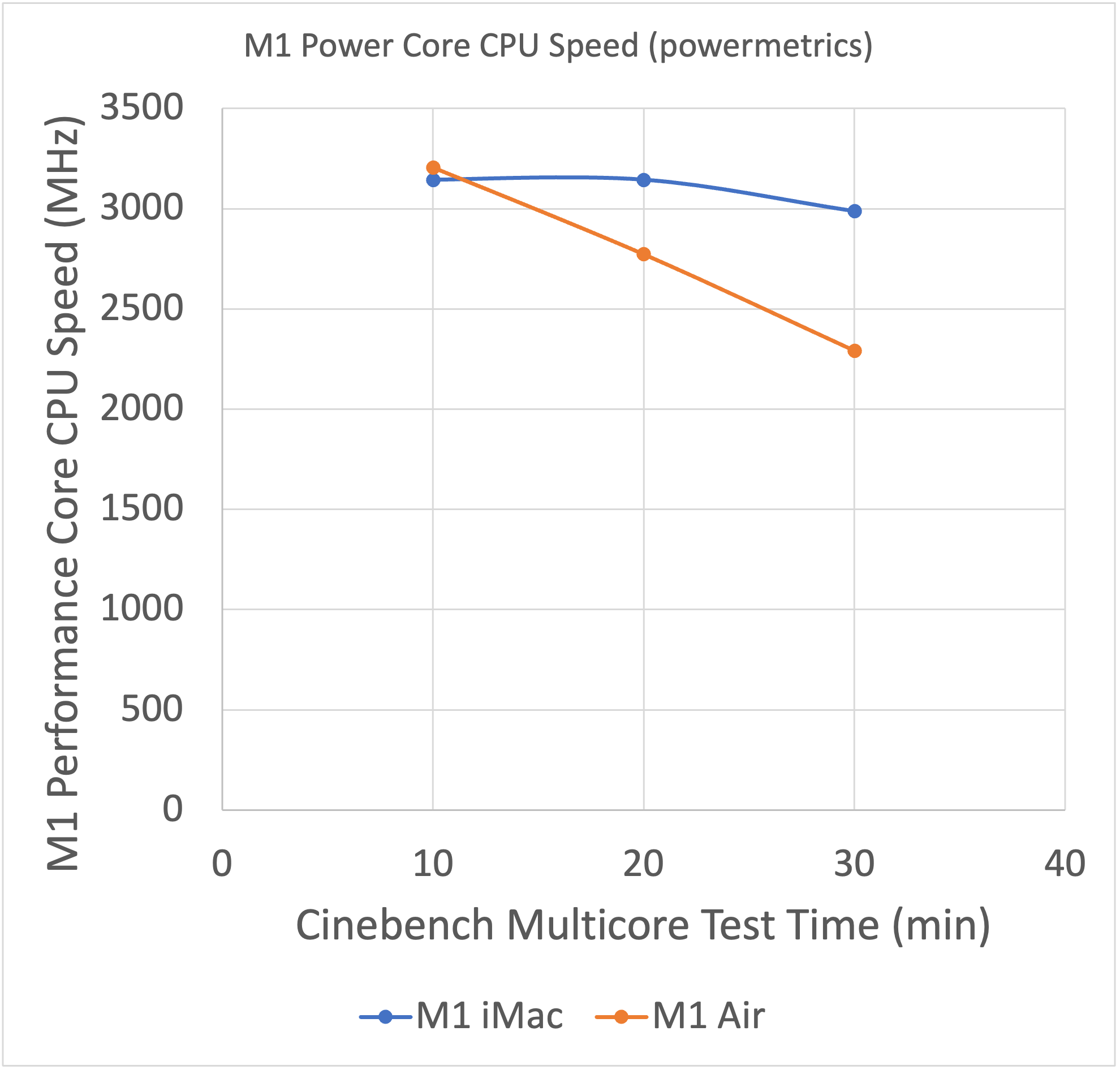

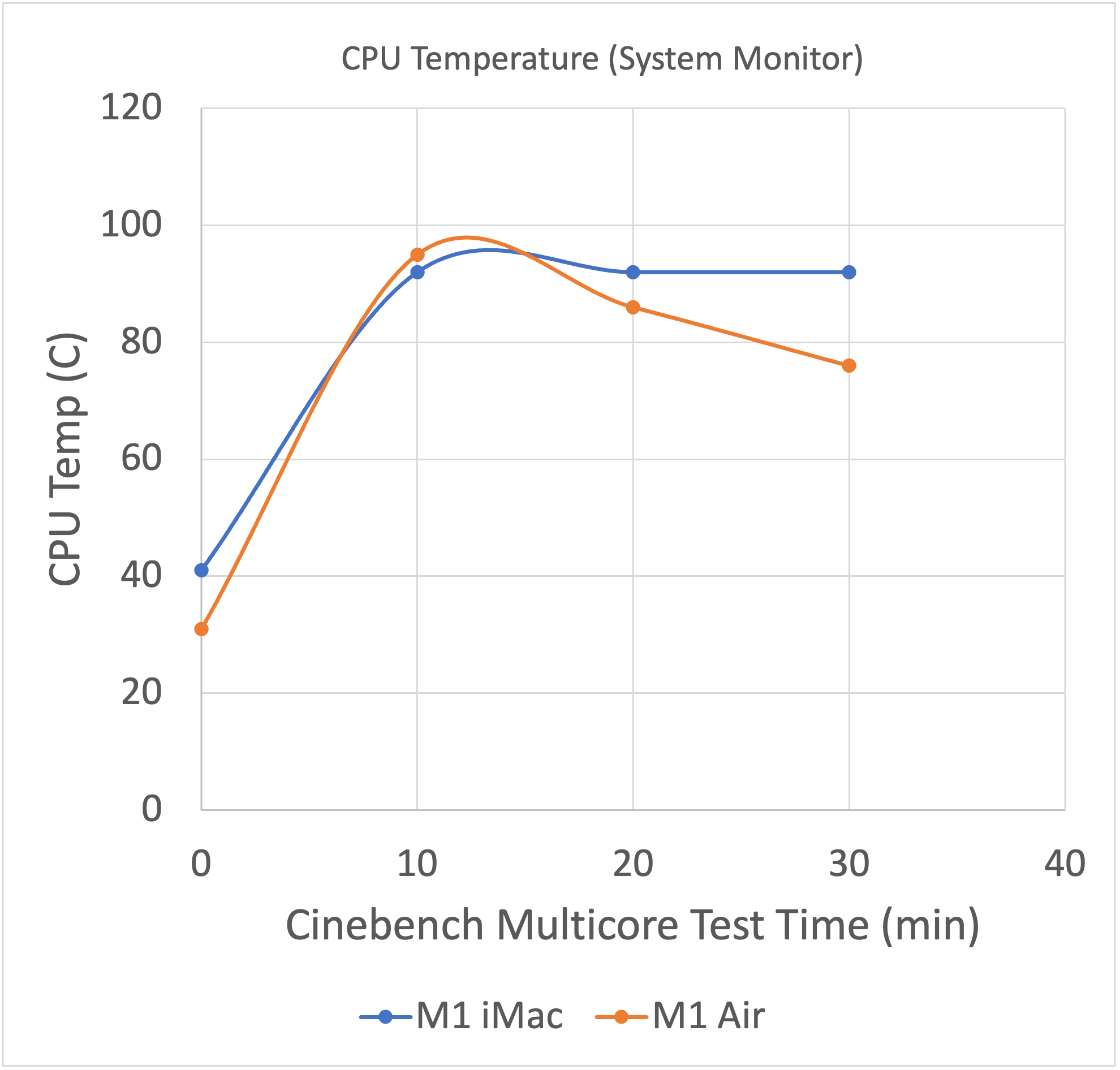

I have an M1 air 16/1T and an M1 iMac 16/1T. Here are some Cinebench results I got from playing around this past weekend.
Note that according to powermetrics (go to terminal and type "sudo powermetrics") both M1 chips operate at the same speeds. The M1 air actually hits higher frequencies for longer (until the heat saturates), so I think the M1 in the Air is a higher binned chip (lower power operation). From watching powermetrics on both machines the iMac M1 typically uses ~500 mW more power for the high performance cores at the same operational frequency as the MacBook Air M1. Also according to powermetrics the GPU in the M1 iMac runs at 712 MHz, while the GPU in the M1 Air runs at 396 MHz. I ran the tests while also running Slack, messages, safari, terminal, activity monitor, excel, calendar, music, and mail in the background on both machines.
The tests were run in a room with 25C ambient temp. M1 air was tested while on battery power. I ran three sequential Cinebench R23 multicore tests and recorded the CPU temperature using System Monitor, the CPU speed using powermetrics, and the resultant Cinebench scores. I pressed go on the next test as soon as the previous test was finished. All three plots are attached below.
It's clear that the M1 air starts to throttle CPU speed as the chassis heats up (I did the thermal pad mod). The iMac fans go crazy during the test (7150 and 6650 RPM) but even while blasting at maximum speed they're amazingly quiet.
