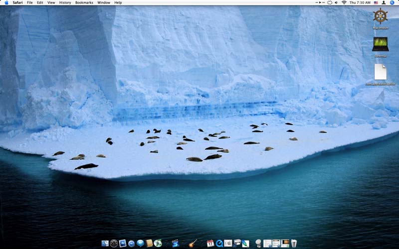

The dock reset but the background still hasn't changed back. Hopefully when train sends me the file it will return back.
would you like to give a little detail of how you reset the dock.. did you do it by delete the preference file or what
also the background of dock or background of desktop
and did you delete your application that modified the dock in the beginning?
the background to the dock. it is still transparent when i reset the dock through the application. I've tried doing it many times, restarts, everything.
Thanks everybody for the help, turns out when i was reseting my dock in TransparantDock, my dock wasn't reseting because i also had Cleardock running so it seemed l iike no changes were taking place. Sadly i had to find that out the hard way by installing OS X over again. Atleast it won't happen again. 🙂
