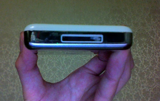

So, as the title says, I've found the dock connector of my 4th Gen. iPod jammed with lint (it looks like some paper and other detritus likely from my pocket), making it impossible to connect it to my Mac. I've already tried removing it with a toothpick, but ended up compacting the stuff, making it even more difficult to remove. Do you have any suggestions for removing it? Thanks.
Picture attached:

I would use the end of an unfolded paperclip.
Just be careful and make sure you have a lot of light to see in and brush it away with the paperclip end unless you can find a better similar sized tool.
I hope that helps.

as for cleaning this one, do not use anything metal like a paper clip, or you'll damage the connector. the tooth pick is good, file it down to a sharper point if you need to.
To reiterate Argon21: Do not use anything metal, like a paperclip or tweezers.
A round, pointy-end toothpick works best, just keep trying. Try inserting it not 'straight down' into the lint, but rather across the entire width of the dock connector, hitting the lint at its innermost point. (So on your picture, have it entering the dock connector at the left, "bottoming out" the dock connector at the right just before it touches the lint.) Then slowly 'poke out' the lint, not trying to dig it out with a lot of force, but just 'brushing' it out.
Or maybe try one of those little plastic swords that bartenders use for putting fruit into drinks... maybe be thin and strong enough. Good luck.
If you still can't get it out, take it to the Apple Store. They pulled some lint out of my headphone jack that I didn't even know was in there. Even if it is out of warranty, I bet they would at least give it a shot...
