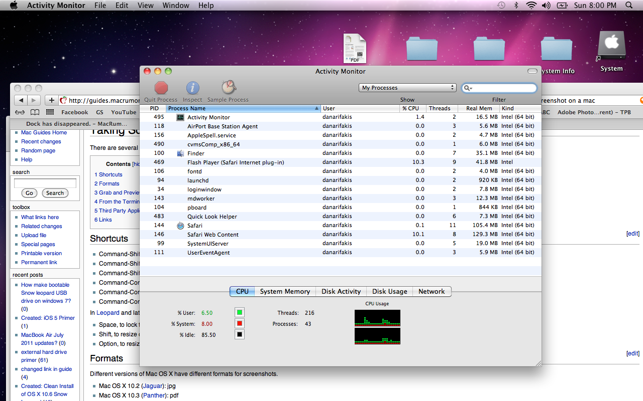

Does the Dock process show up in Activity Monitor?

No Dock in Activity Monitor, here's a picture to make sure:
