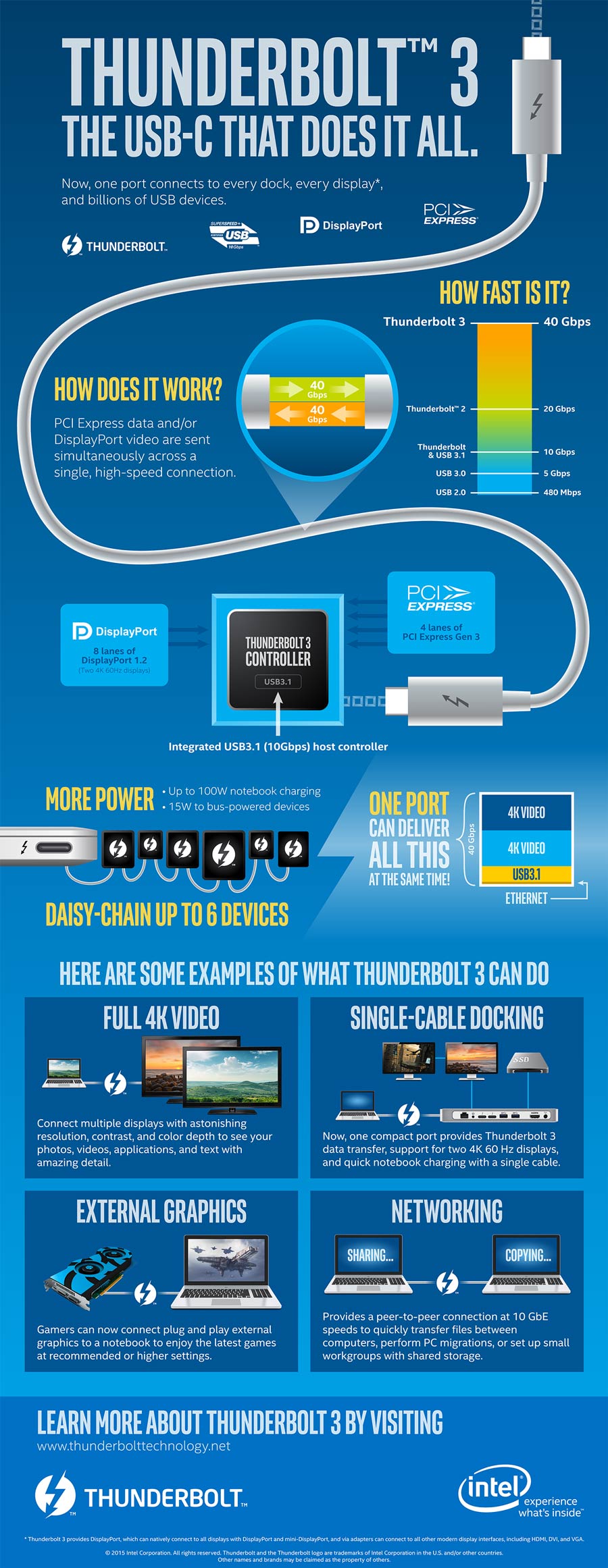

The official Thunderbolt website. They have a nice infographic about Thunderbolt 3:
Even nicer is the following presentation (slides in a pdf) which has a very nice schematic overview of the Thunderbolt controller (starting at slide 10).
Okay, now I'm confused. Does the new MBP support Thunderbolt 3 or not? It seems that something that hosts USB-C might not host Thunderbolt 3. Check out that ©2015 on the bottom of that document.
USB-C is just a connector. A device that uses it might support Thunderbolt 3, USB 3.1 Gen 2, USB 3.0, or even USB 2.0.
The MacBook Pro (late 2016) has 4 USB-C ports and all support Thunderbolt 3, USB 3.1 Gen 2, USB 3.0, and USB 2.0.
That is correct. USB-C is only hardware: a connector and a cable. It is used by both USB and Thunderbolt 3. In general, if the connector has a lightning on it then it is a Thunderbolt 3 cable that only works with Thunderbolt equipment. When it doesn't have that symbol then it is a USB cable and will work on both USB and Thunderbolt devices.
The document I posted is about Thunderbolt 3 only, not about USB or USB-C. Thunderbolt 3 uses USB-C as its connector and it also incorporates a USB controller. I posted it to answer a question about the USB controller that is now integrated in the Thunderbolt chip.
The new MBP only comes with Thunderbolt 3 ports and thus supports both Thunderbolt and USB devices. The port uses the USB-C connector since that is what Thunderbolt 3 uses.
I love the PHOTO. TOO BAD Apple has a flagship LAPTOP with Thunderbolt 3 out now, but didn't release any peripherals along with its release? No DOCKS, no eGPUs, nothing? They didn't even put a free dongle in the box, and they just want us to use the USB-C adaptors intended for the 12" MacBook? Not much if any of the TB3 adaptors on the market work, I bought a bunch and returned them... So the early TB3 adopters have a new laptop but have to buy an older adaptor, then wait for a proper TB3 to replace it. FUN! Its such a weird Apple Universe.. I don't quite understand it. Apple seems to have taken a dive since October 2012.. Tim Cook is then new Steve Ballmer, this seems clearer now. Apple will flub along like Microsoft did.. burning cash and its users.
Why would Apple need to do that when there are plenty of USB-C peripherals out? I'm fine with that as Apple has shown they have never been really any good when it comes to peripherals (printers, cameras, displays, mice).
Besides that, you really need to start reading what Thunderbolt actually is. Just looking at the picture is not going to help, read the text that's on it. As stated before, the laptop has Thunderbolt 3 ports and thus is able to connect both USB and Thunderbolt devices. Dongles and adapters are not a necessity, most devices require a different cable with a USB-C connector instead of the USB-A one.
This has been well known ever since Intel announced Thunderbolt 3 and can be found on the official Thunderbolt website. That's almost a full year before the MBP announcement!
In other words: troll be gone!
