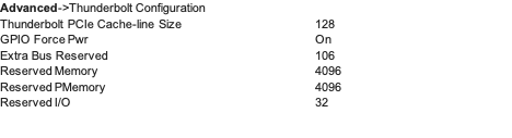

can this script dump the thunderboltdrom or make a section for coreboot/tianocore for efi-properties for thunderboltdrom injection? thx
