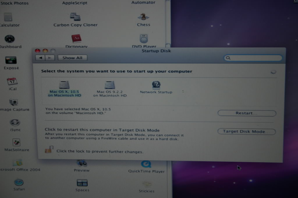

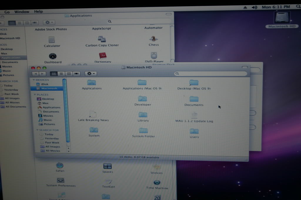

i took pics of the current setup, does this make sense? please explain it to me. maybe he upgraded from os 9? how can i boot to it?
You should be able to boot to the OS9 install by selecting it on the Startup disk window and clicking Restart, or by holding Option when you hear the Apple bong at boot.
pic
pic
