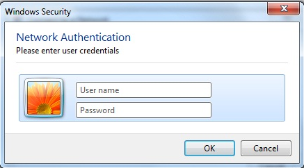

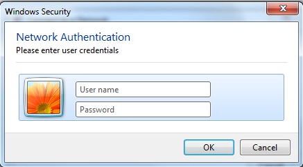

It should be possible. When I monitor traffic between a windows workstation and the switch, I can see the switch (HP, btw) asking the client to provide credentials which invokes the following box (imaged below), Unless i'm misunderstanding the handshake process. I can't understand why we can't do the same on OS X.
