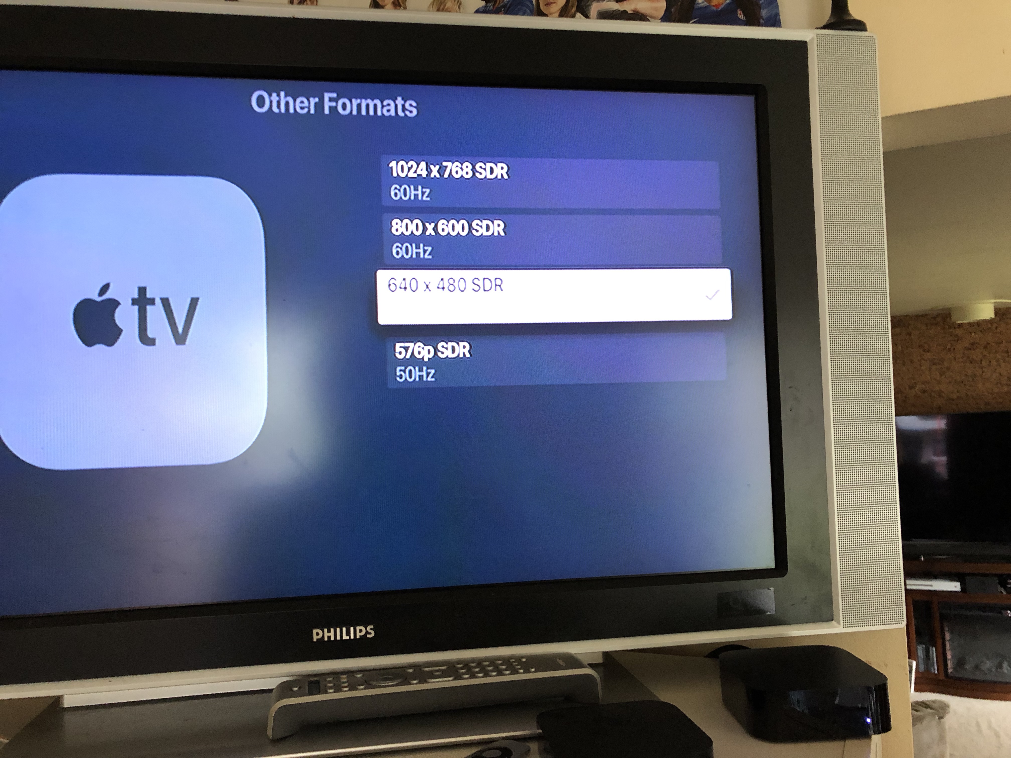

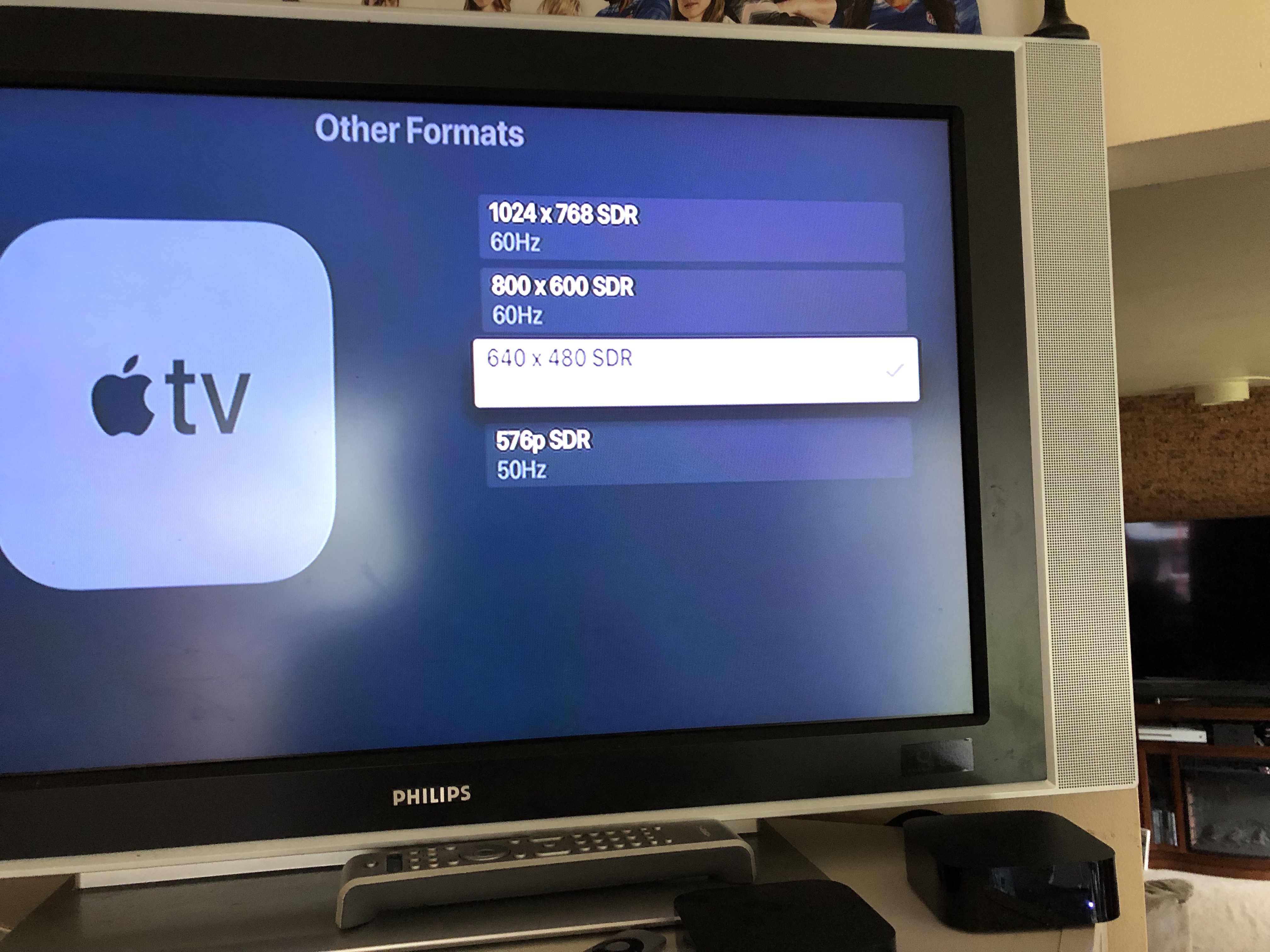

Freak, I don’t know that screenshot you’ve posted, I don’t know that that’s the same thing as 480p that you have highlighted. Those are like computer screen resolutions which I think are different than TV resolutions. On my TV, I don’t have to go down into “Other Formats”. 480p is listed on the first page of formats along with the other standard ones like 1080i, 1080p, 720p, etc. On my TV it doesn’t say 640 x 480. It says 480p.

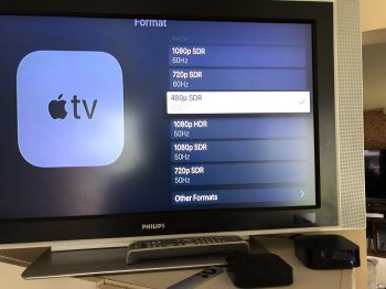

Ah, I posted the wrong photo! I've tried both "480p 60Hz" and "640x480 60Hz" on the 720p-native, as well as on the 4K.

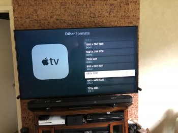

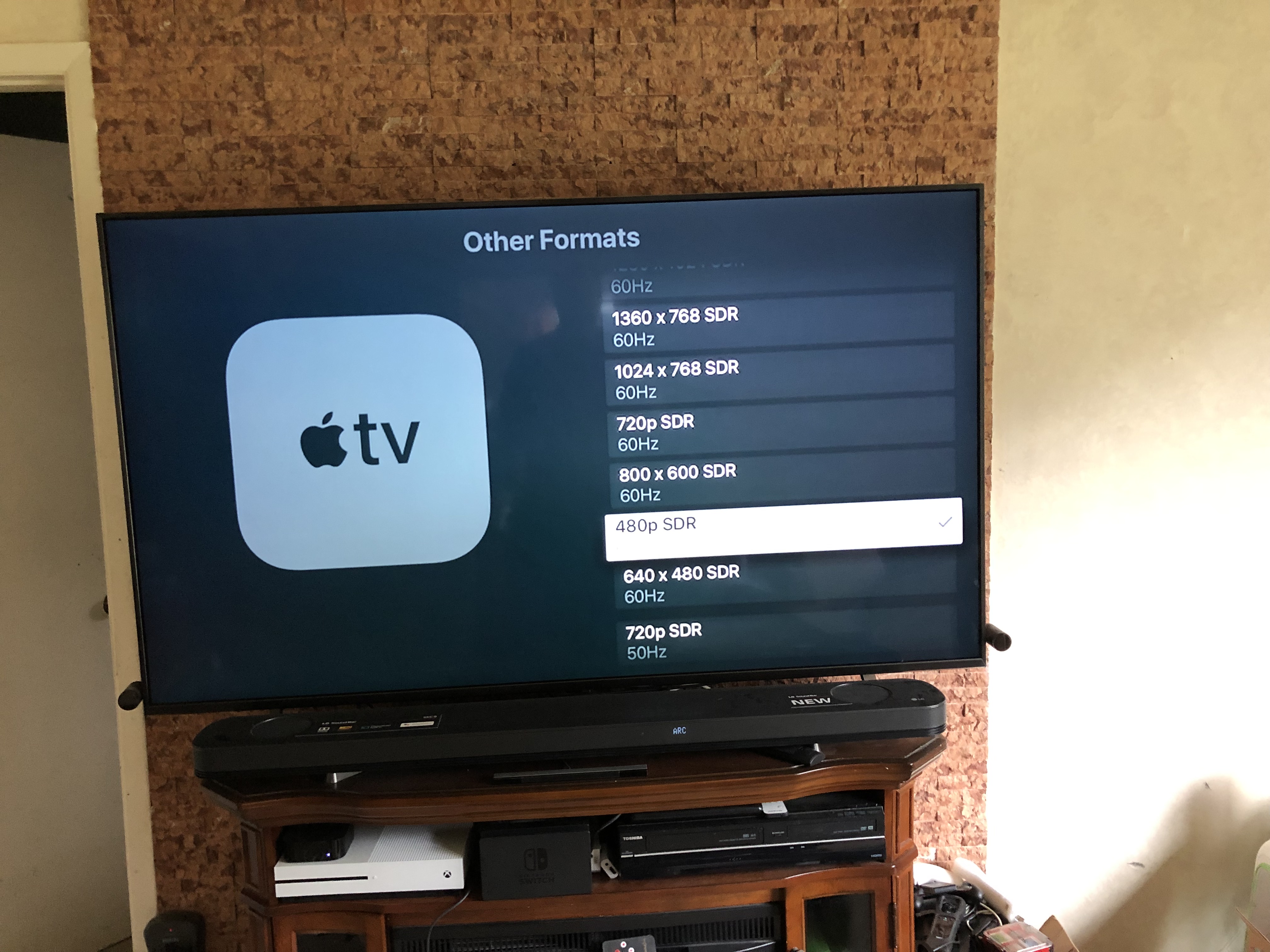

On the 4K TV, "480p SDR" only appears under "Other Formats" not on the main page, "640x480 SDR" also appears under "Other Formats" on the 4K TV.
480p SDR appears on the main page on the 720p TV. As does 1080p, which that TV doesn't even support. It will accept a 1080i input, but downsamples it to 720p.
Here are 480p on both:
