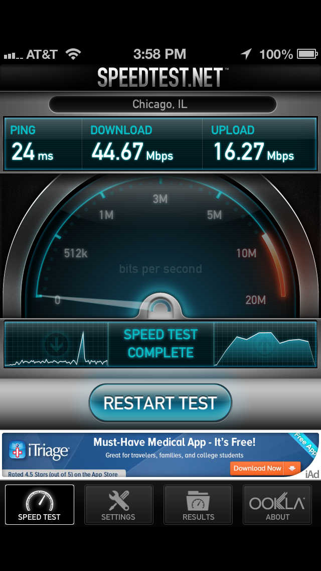

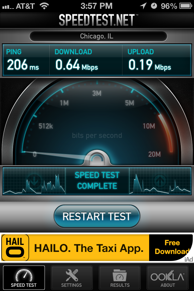

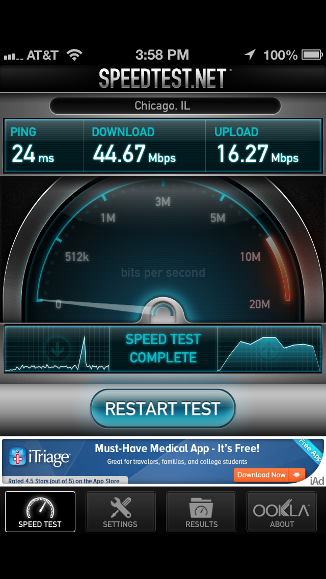

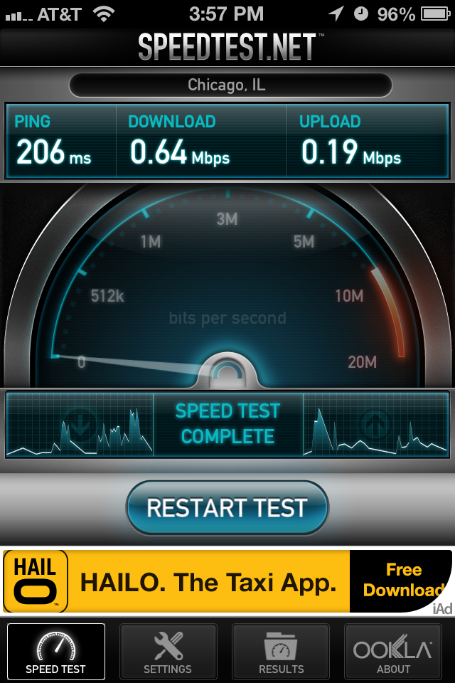

Here's two speedtest results as well. The 4S and the iPhone 5 side by side. Again, I didn't see the issue with the 4S until 6.0.1, and it's consistent on 2 different phones here.
