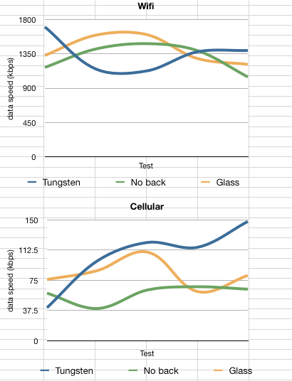

Did the test
So I went ahead and tested reception with the standard black glass back, with the tungsten back, and with no back at all. Results were conclusive; the difference between the backs makes no difference for wifi reception, (within a standard deviation of each other), and for the cell data speed, the tungsten back showed significant improvement over the others.
average over 32 tests* at each configuration:
Tungsten back average speed (wifi/cell) :1350 kbps / 105 kbps
Black** Glass back average speed (wifi/cell) : 1406 kbps/ 83 kbps
No back average speed (wifi/cell) : 1302 kbps/ 59 kbps
so obviously, message here is, metal backs do not hamper your data connection, they may actually increase it.
*tests conducted in a basement laboratory at my university to establish a consistent signal. Also attests for the slow speed.
**I'd love to run this test with a white iPhone 4. I get the feeling that the hold up for the white model was caused by signal attenuation.
