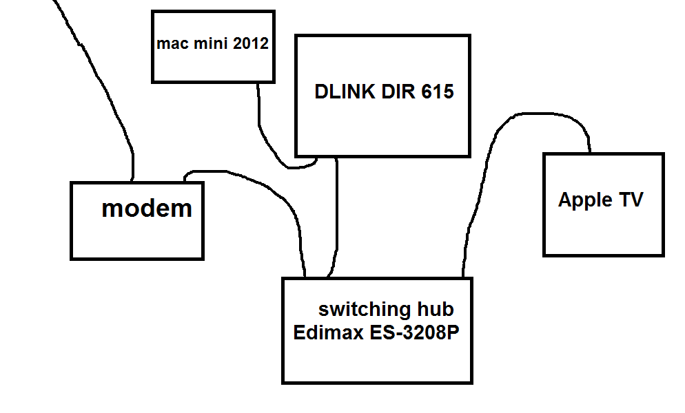

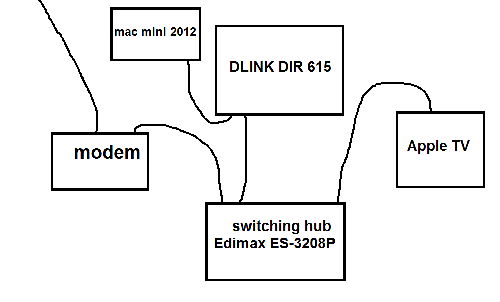

My Apple tv connect by ethernet through switching hub Edimax ES-3208P and the switching hub connected to the router Dlink dir 615
Maybe the AirPlay don't work because of the switching hub?
I attached simple diagram of my home network
Modem should be plugged directly into router wan port. Switching hub Into one of the other router ports, then your Mac mini into the router, and the Apple TV into the router or hub. The diagram you have will cause routing problems.
Thats right, that will make it work OP
Your router needs to control the switch, so that it can route all traffic on your network. Your router knew the Apple TV existed using WIFI because you connected the Apple TV to the router, you just need to replicate that using the ethernet cable.

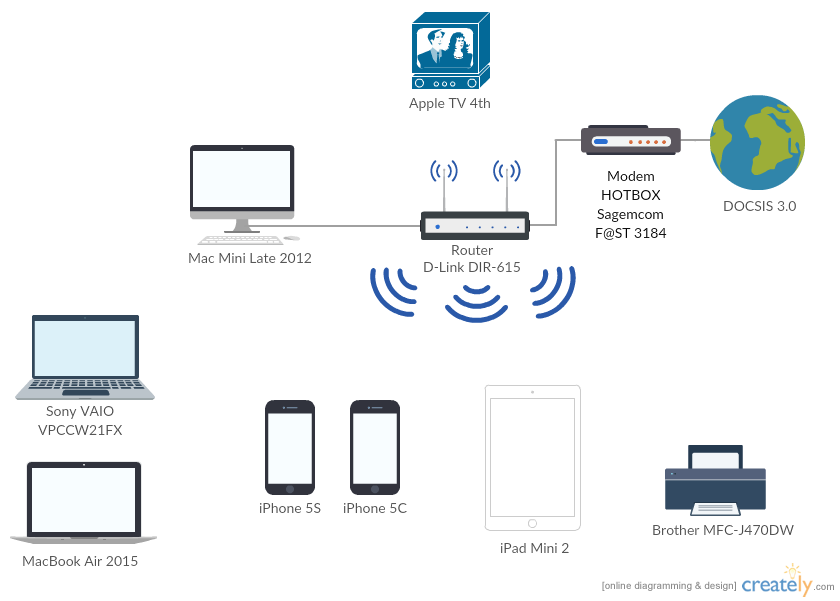

I attached my home network diagram
I dont know how to connect between the router and the hub because they are located in different places.
Your original post said you were attempting to connect your ATV4 via Ethernet - what is on the other end of that cable?
