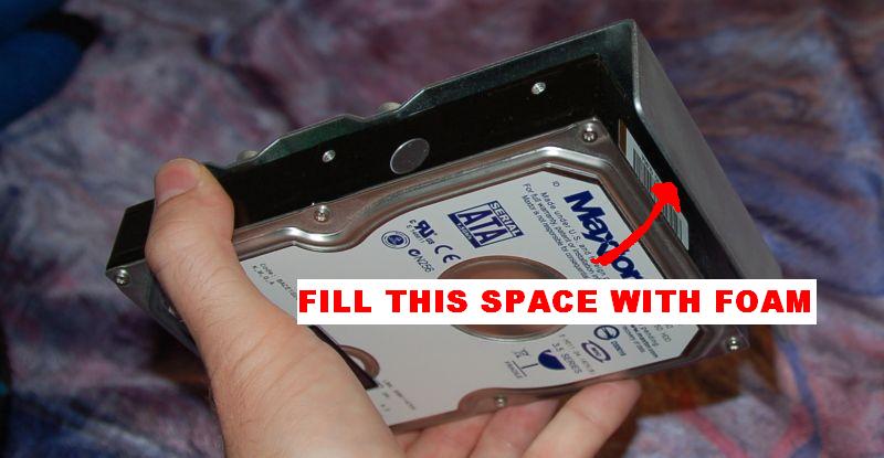

I have found a source of vibrations in my MacPro with stock WD 250Gb and Samsung HD401LJ 400Gb. After some time even rubber between HDD and HDD rack didn't help. So I started to test around and I have found out that placing foam between HDD and front part of HDD rack (where we grab it to pull it out) eliminates most (if not all) of vibrations. Looks like vibrations do cause the front part to vibrate slightly.
Look at attached pic. Try it out!
