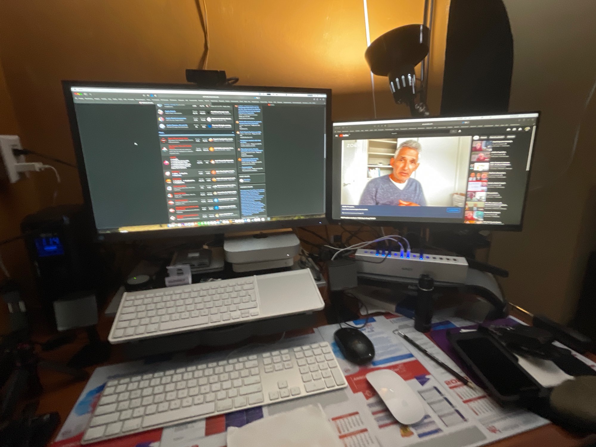

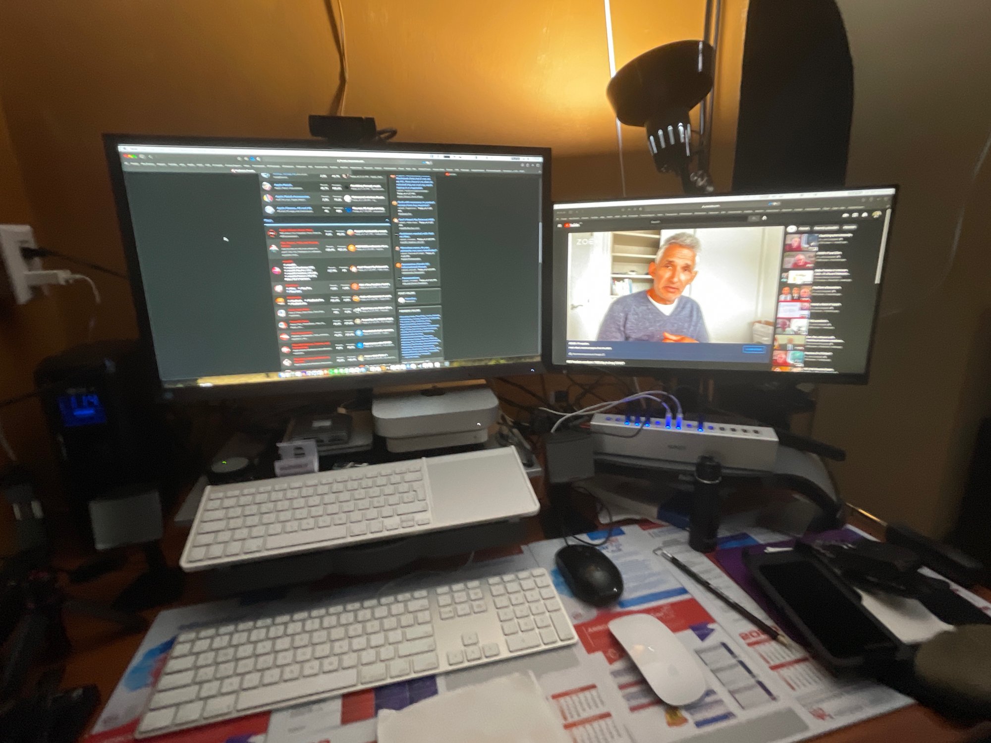

I had video problems when I had my Mac mini m1 connected through old HDMI and DisplayPort cables. once I updated the cables, I have toe monitors one through the usb c to display port cable, and the other one through the HDMI to HDMI cable. No video o monitor problems whatsoever. Mac even wakes up through the Apple Watch with no problem. very happy with te setup.
The following two cables helped me change the connections to the Mac mini m1.
The HDMI to hdmi cable used is the one that came with the monitor.
usb to display port cable this cable stopped all the video problems
usb c to usb b cable this permitted an old usb 3 hub to be connected to the usb c port of the Mac mini.
