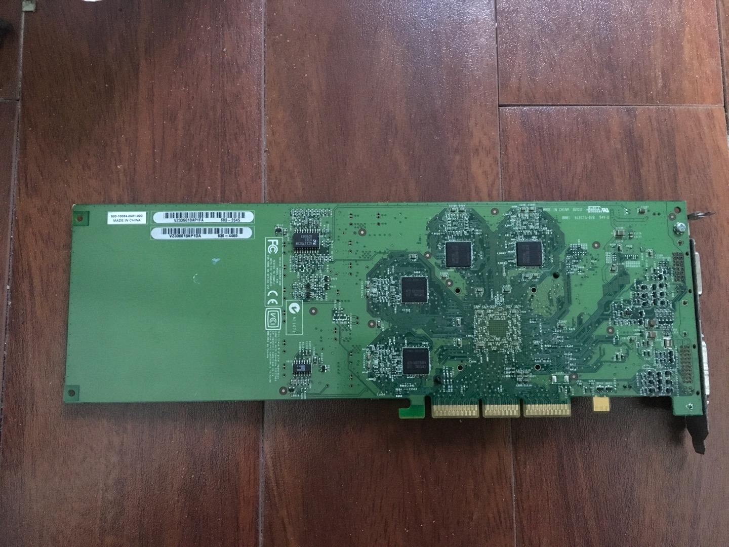

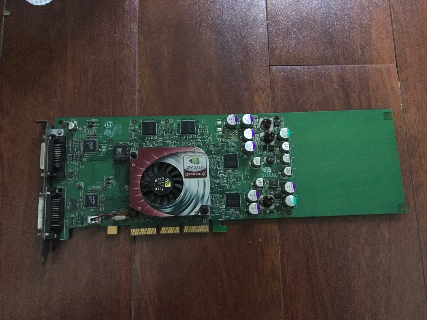

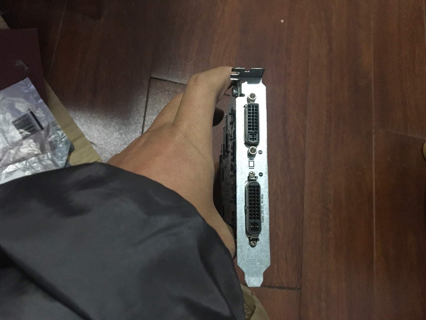

I just got a GeForce 4 Ti4600 (Mac Edition), but this graphics card has been flashed into a PC vbios by the original owner. Has anyone just backed up the original Mac vbios file? I hope you can share one with me, thank you. IMG_0126.JPGIMG_0127.JPGIMG_0128.JPG
Thank you very much for your reply. I have collected the website before. However, the PC card uses the dvi interface, and the Mac card uses the ADC interface. The ADC interface includes power supply, so I have not easily tried to use the bios of the PC card directly.
