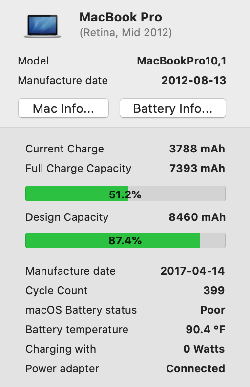

Attending a conference in DC until Thursday. This morning, my 2012 MBP wouldn't turn on. I had it charging overnight. It turns out that I can power it on when it's plugged in, but when I disconnect the power, it abruptly turns off. The battery is stuck at 53% charge and is not charging when it is plugged in. At least as of a couple of weeks ago, Coconut battery was showing good battery health. I did replace the top case and keyboard about a month ago so I am wondering if the battery connector is somehow loose, but I don't have any tools with me to open it up and can't find anything near the convention center/Apple Carnegie Library where they might sell a pentalobe driver. At worst, I can just keep the laptop plugged in, but I'm thinking there must be a MR member nearby who has one I could borrow, rent, or buy!

Thanks for that suggestion, I did try doing a PRAM and SMC reset a few times without any luck. (I didn't do it 7 times, though!). After I opened it up, cleaned off the battery connector, and reseated it, it still wouldn't work. Luckily, I just happened to have an unused NuPower battery so I switched them out and now it seems to work fine. It seems strange to me, though, that the battery is shown as holding 51-53% but won't charge and won't keep the Macbook on without being plugged in. Has anyone else encountered that situation before?
