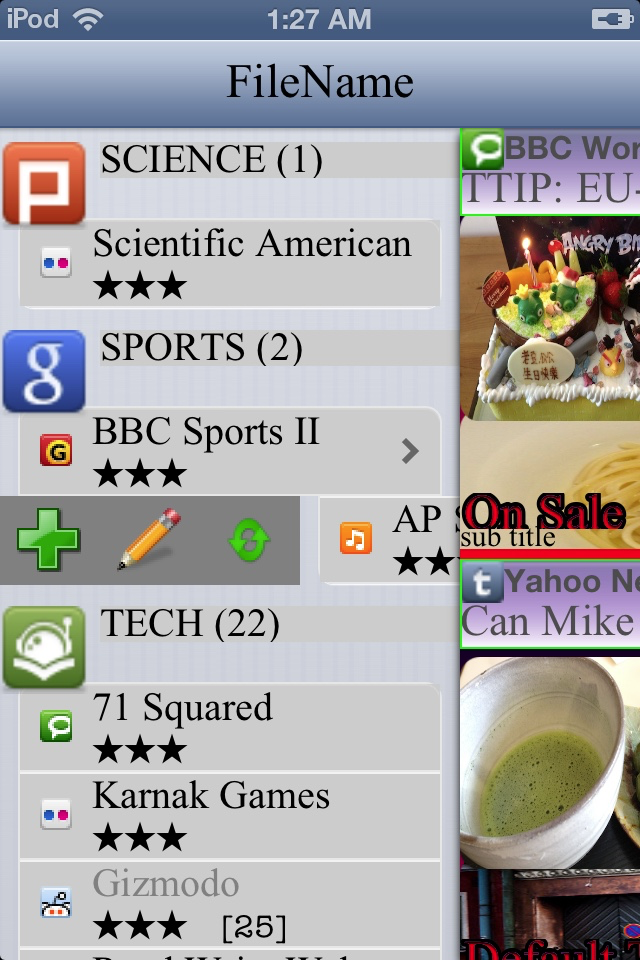

Here's the FRC, I used the "groupedBy" to group the results into seperate groups based on a field in CoreData.
Code:
    NSFetchedResultsController *myFRC = [Contact MR_fetchController:myFetchRequest
                                                              delegate:self
                                                          useFileCache:NO
                                                             groupedBy:@"category"
                                                             inContext:localContext];
This gives me a table where I can have all the sub categories listed. This would be the same as the top 2 levels of a discussion list where you have all the topic as categories with all the postings listed in their group. I use this for a contact selector, where you have all the contacts listed by type.
The upside of this is that management is automatic. CoreData manages add/edit/delete.
In this screenshot, science, sports and tech are from a field called 'category' just as above in the 'groupedBy'
BBC, AP are just records with the same category.
The table is managed automatically as records are added so there's really no work on your part.
This is the slide out for the hidden buttons that control the Add/Edit/Refresh (or whatever you would want them to do)
This is the right side of the slide out that is used for delete.
So all the updates from the datasource (both ways) are automatic. I don't have to worry about the category going to zero or adding more records, the FRC takes care of that. It can even be used for caching results and updating other parts of the app.
I didn't go further with the "drill down" because I needed the slide out hidden menus. The slide outs are from the same GitHub as the slide out for the left/right view so there's a drill down hidden slide out system.
Again, all the work to manage everything (add edit delete) is automatic because it's built in.
I made this a "blue print" so that when you double tap the top bar <where it says "filename" you it swaps out to another feed source automatically.
The code I linked in the above post was a different option and I didn't take the time to merge the features of it into the hidden slide out system.
I don't know offhand how FRC would handle categories of categories of categories... I image you could just grab each one as needed or when the user slides out, have that sub-topic come up in a new table.
I don't know your screen layout system, but what I did is a different kind of drill down. It allow the whole topic/category to take up as much of the screen as you want and you just slide out the picker menu on the left.
Even the view on the right is a table view of collection views. This give a separate scrollable categorized view of the information that comes from the left where you pick the sources.
You might think of this as a different way of seeing the same info, it's just hidden so that you get more screen size for the views.
I don't know if this is even close to what you had in mind or not, plenty of different ways of displaying the same info.
I personally like a large window of data with hidden controls for sources.
Let me know if you'd like more info on this or if it's not something of interest.

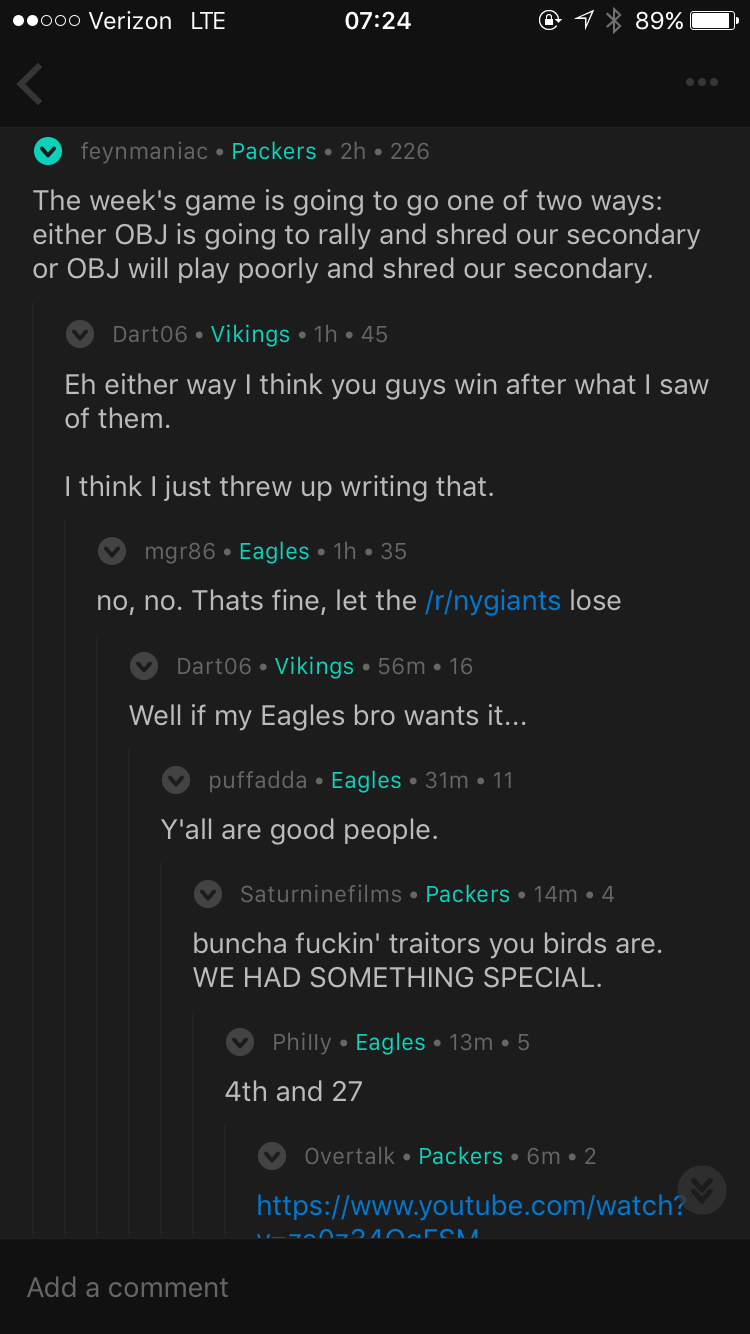

So here is a screenshot of what my initial question was trying to achieve.
I wanted to know how they created the effect of having a top level comment (e.g. someone replying directly to the thread) and having all replies shift to the left (and reply to the replies.....etc...). This can potentially happen an infinite amount of times for any comment, so I can't hard code a limit on how deep the replies can go.
Example. An array contains 5 direct thread replies. The 5 top level replies also hold replies to them as well. These are all the same type (A class I named CommentModel). Each CommentModel has a property called childComments which holds the next level of comments below it etc... "childComments = nil" if there are no replies to that comment and the node stops.
0 = Top level reply directly to thread
1 = Reply to top level
2 = Reply to 1 (first reply)
3 = Reply to 2 etc....
0 -> 1 -> 1 (has to two replies directly to the top level comment node)
0 -> 1 -> 2 (has a one reply to the top level comment node and one reply to the reply node..I know it's getting confusing with redundant words)
0 -> 1 -> 2 -> 2 (one reply to top level comment node and two replies to the reply (1) node)
0 (top level comment with no replies)
Total number of rows to view all comments: 12
So if I use the expected way cellForRowAtIndexPath, I will only get 5 rows, since the initial array has hold 5 top level comments, but each comment could have associated replies.
So, my solution (I can post code if you're curious) was using a combination of recursion and node tracking
1. Flatten array so all nested comments are moved into a flat array.
2. While I parse this, I set a property called nodeLevel which specifies how deep the reply is.
3. Pass that array to the tableView which now has the correct count to view ALL comment and replies for a particular thread.
4. I added an AutoLayout constraint out for the left margin of the cell and set it's constant = (nodeLevel * 10) which will then indent to the appropriate distance based on what level the reply is.
There may be a simpler approach or UITableView CAN deal with a tree structure, I'm just not aware of how to do it...

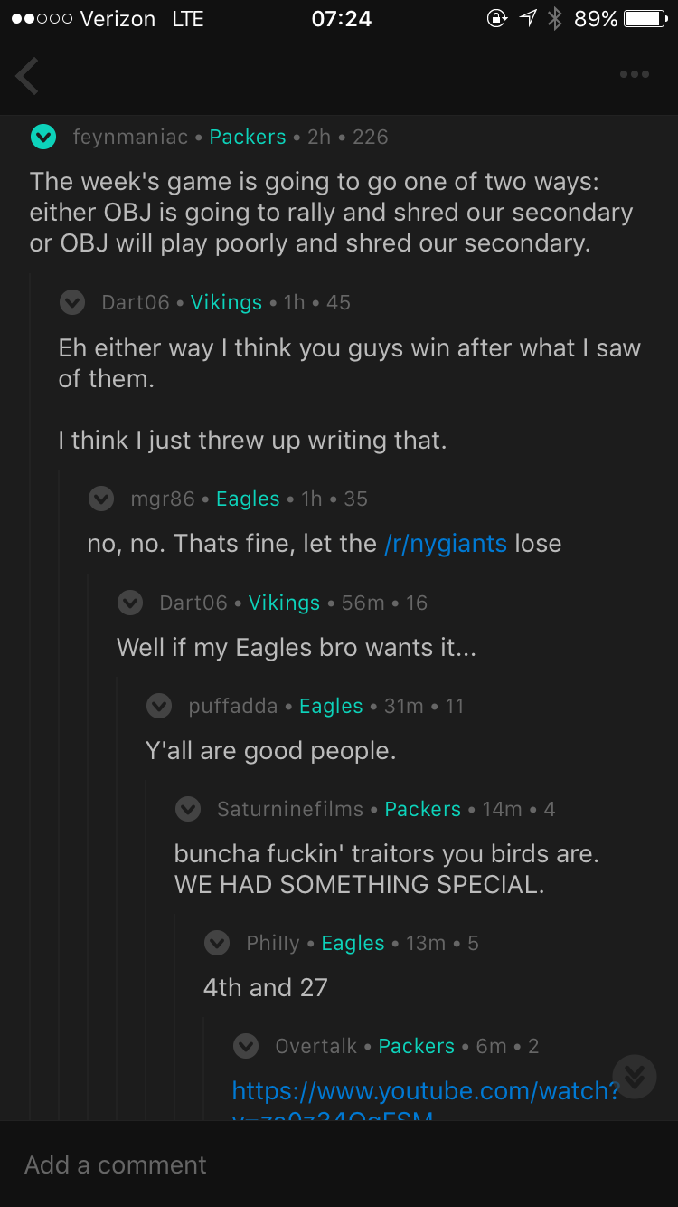

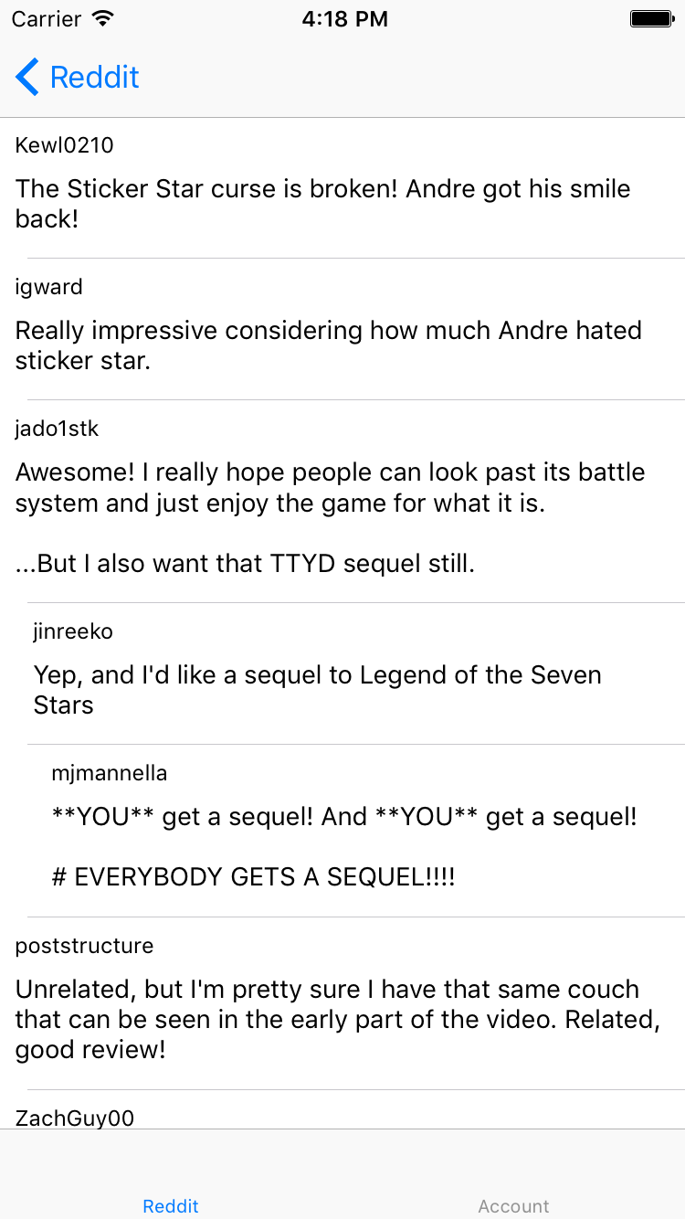

The data is getting returned from REST response with JSON data. I have a PostModel type that has a "comments" property, which holds the comments for a specific post. This isn't populated until the user will select a post to view.
I looked into RATreeView but I felt it was overkill for what I wanted to do. A lot of times I feel that trying to wrap my head around 3rd Party Frameworks and getting them to work in my project, which may have slightly different use case to be more work than just doing it myself. On top of that, I typically like to know how to do things myself before using a framework that has lots of bells and whistles.
My code is actually pretty light weight. It's maybe < 25 lines of code?
Yea, I don't need the "Add/Edit/Delete" part since this is just displaying comments that were returned from the URLRequest.

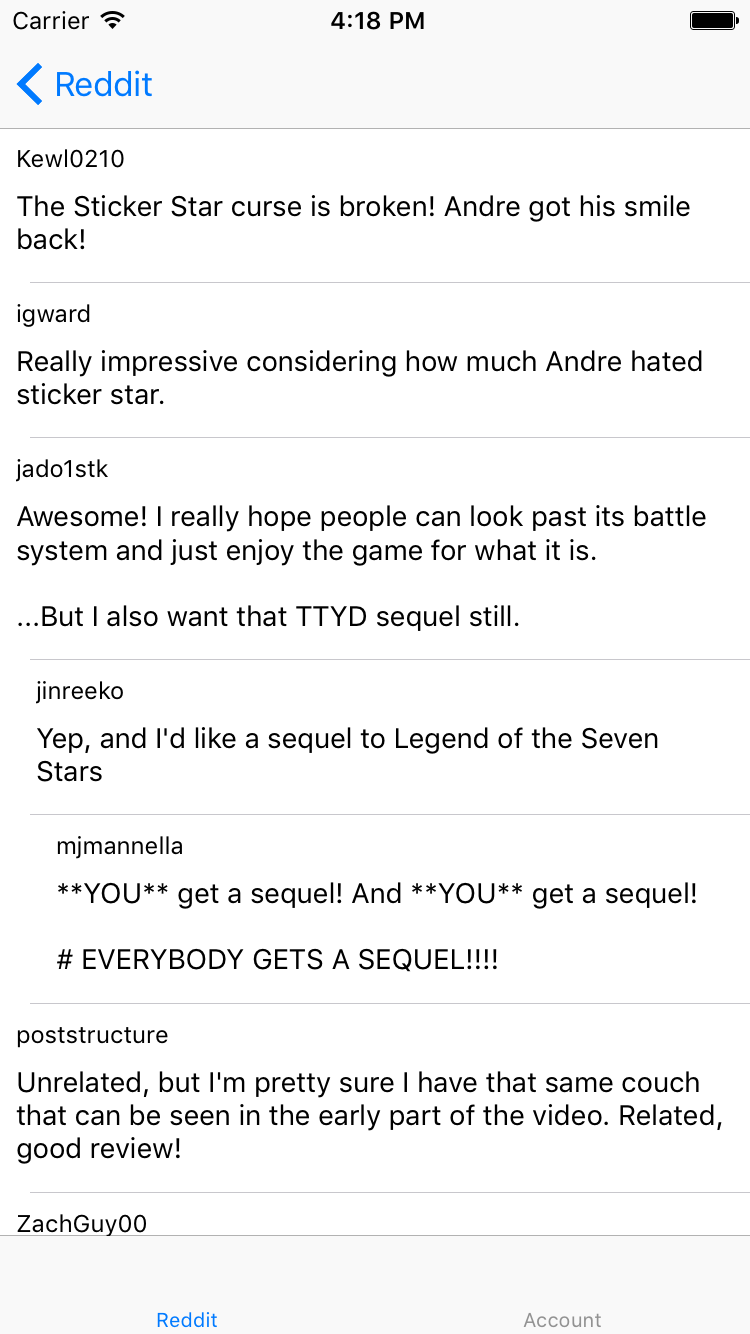

On that pic I posted, there are scrolling RSS data feeds that are shown on the right.
I downloaded several 3rd party tools to do scrolling text. Had a BAD time trying to make them work, they had so much stuff like spacing calculators, speed calculators, etc..
I couldn't even get it to scroll right unless the length of the string was greater than the length of the field, so I padded the string with spaces just to get it to work right.
This is why when programmers interview for jobs, they want to see the code, it's a PITA to try and figure out what someone else's trying to do, much less try to debug or change behavior.
That's exactly what I had to do. Even the two slide outs didn't work with each other.
If you're curious what my solution looks like check it. It's not the prettiest yet, but works. Next is to make them collapsible.
That looks great. So it's a tree structure and when a cell is requested, you look at the prior cell to find the location and see if the next cell is a part of the same branch, otherwise you walk back up the array until you find out what should be the next cell.
I'd like to see the code for that logic, if you don't mind. I can imagine a simple limited depth one, but you don't know how deep it goes (unless you set limits).
In other words, you could use a for..next inside of a for..next inside a for..next, but that's going to have limits.
You'll have to use recursion to do it right.
One option would be to use a mutable array and keep track where the header is. Maybe a count of how many are showing under the current header and then when it's collapsed, remove that many cells from the display.
I guess all the information you'd need would be in the count of each branch, but the mutable array could keep a code for what type that element is, either a text or another branch.
Does your array just store arrays or texts mixed? If so, just check for type would work, otherwise, count alone should do the trick.
Either way, it looks like a pretty useful code snippet to have.
