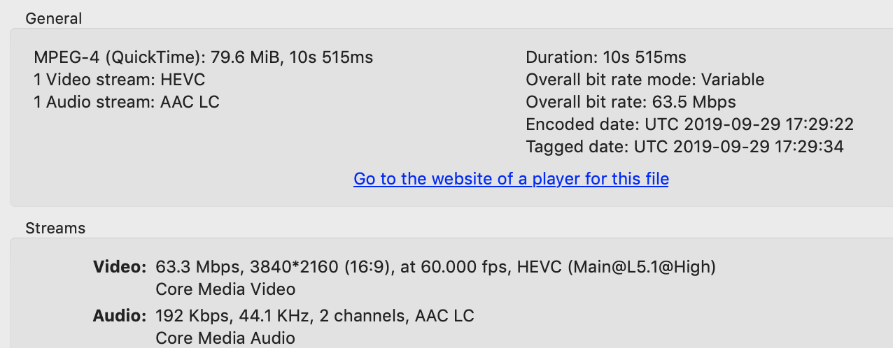

When I tested the numbers on my Pro Max for 1080 HD 30, 1080 HD 60, 4K 24 fps, 4K 30 fps, 4k 60 fps I got:
10.1, 15.2, 32.2, 28.8, 63.3 Mbps.
Not sure why the bitrate for the 4K 30 (28.8) was less than the 4K 24 (32.2). It was a static 10 second shot using the ultra wide lens.

4k 60fps 63.3 Mbps? Are you sure?

Thank you for the info! Man that just seems more compressed than I'd like. My few year old iphone 8 is at 54 Mbps, it's a shame they don't allow a "high quality" option.
