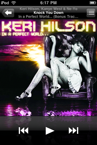

I have a first generation iPod touch with the new iPhone OS 3.0 software. Now tell me if you see a problem here.
NO VOLUME CONTROLS
This isn't just in the music player. It is in every application! 😕 Please help me if you can. 🙂

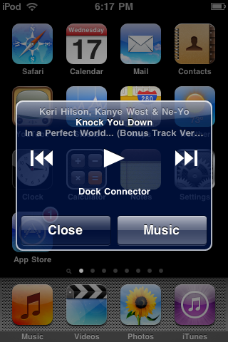

I'm not sure if you have it plugged into a dock or not (the 'Dock Connector' string just above the play button?), but I read somewhere that the volume slider disappears if you don't have headphones connected.
Does the slider appear when you have headphones plugged in?
On a 1st gen touch it can tell if no headphones are connected, and since there is no internal speaker you won't get a volume slider. Plug in headphones and the slider will appear.
You could previously control volume from the Touch when docked to a speaker dock, but now it's all up to the device you're docked to.

yeh it means your earphones are not plugged in, god knows why it says dock connector when theres nothing plugged in
"dock connector" is simply the only choice left on a first gen when no headphones are plugged in. It simply means audio is routed to the dock, whether anything is there to use it.

The reason it did that was because you plugged in the FM transmitter. My brother has a second generation iPod touch and when nothing is connected (unlike my first generation) the volume control remains.
It looks like the dock connector is acting just like a line-out now. It assumes whatever you've got plugged in will take care of volume control. So far that's true for any of my dock devices. Since Apple is now encouraging developers to work on docking devices as well as apps, they pretty much had to standardize the output to the docking connector.
