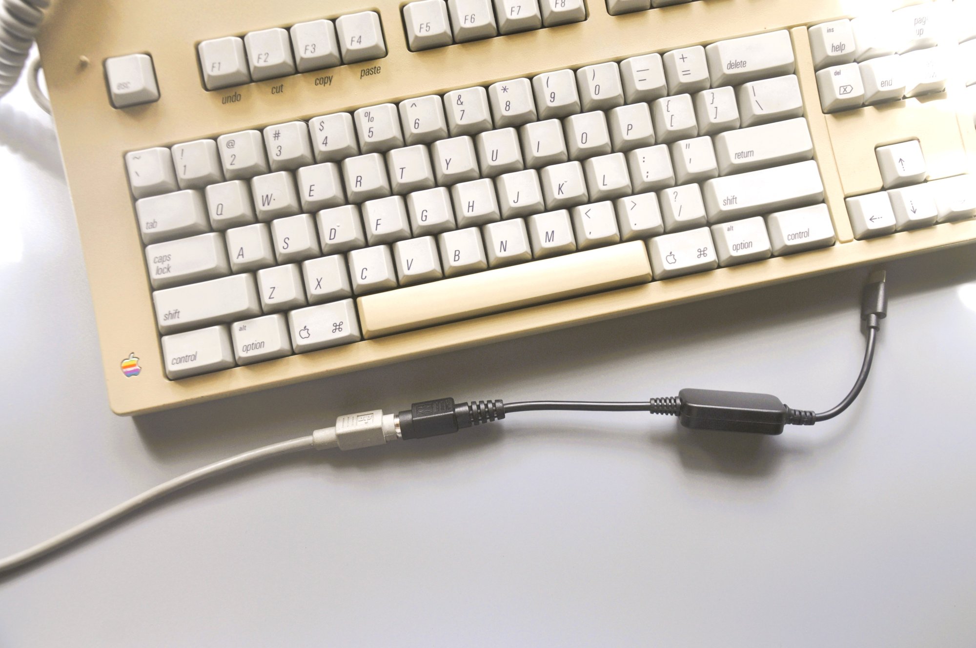

For those looking for converting your ADB keyboards to USB, I do sell an ADB to USB converter. Here's my newest USB-C version.
