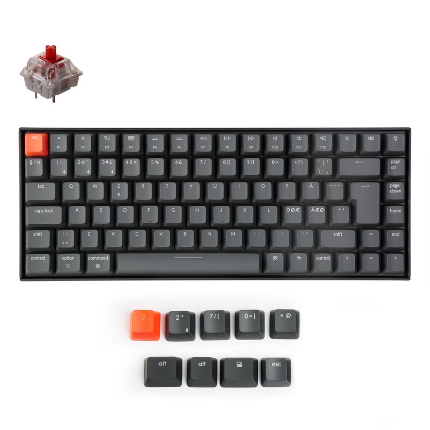

The Apple Magic Keyboard is nice, but I'm missing some backlight to the keys, so I just ordered this one with Mac layout:
Yeah, I'm not looking for a mechanical one; I already have the original mechanical keyboard and it's just exhausting to use when you type a lot, and I'm not excited about the noise either. I also use the layout of a rare language which limits my keyboard options even further. I mean I've tried English layouts and you can still type the special additional letters that my language has, but the pain comes with all the basic punctuation characters and such because for some weird reason they have to be in completely different places and then you end up pressing every key with every possible modifier just to find an asterisk or something because it's not where it has that symbol on the physical key.

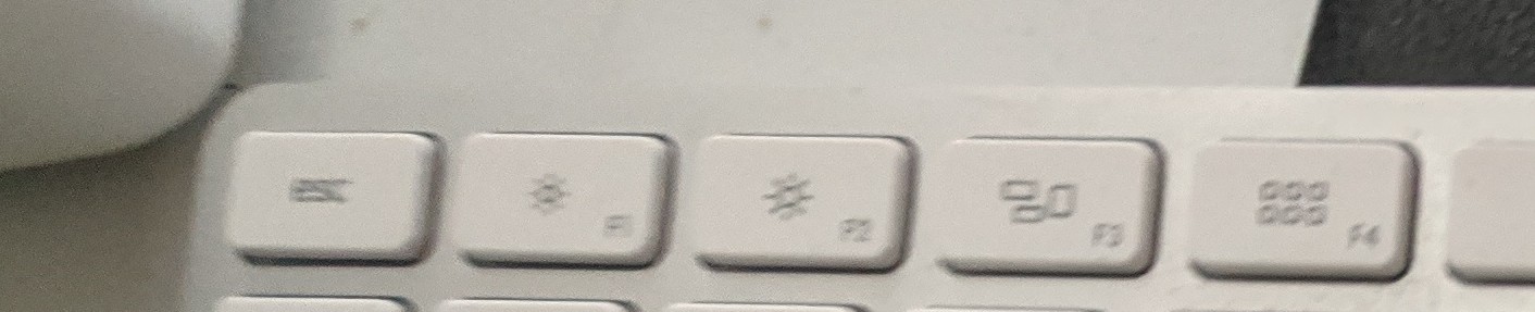

@Riku7 And specifically when we're talking about the differences between the same basic keyboard:
These aren't great, but I couldn't find any pictures of the difference online, and I did look a while. The top is an MB110/A, and the bottom an MB110/B. They otherwise share an identical keyboard layout, but Apple managed to break the otherwise normal media keys so they don't work in older versions of the Mac OS.
It also feels like no one ever really looked into this. That I had to take these pictures instead of find better online says a lot.
