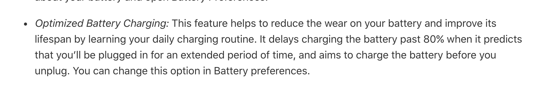

Charge the MacBook Pro battery - Apple Support

There is a setting for battery longevity in the system preferences, it works just like the one on the iPhone.
In the two months, I have owned the 13PM, it has never stopped charging at 80% and my routine is the same. And I also have an alarm in the bedtime set, so it definitely knows my routine. It just goes straight to 100% everytime.
Reactions: zarathu
Mine did the same thing, it can take a couple of weeks for it to stabilize and do the 80 to 100% charge at the end. Mine has told me in a message a few times that 80 to 100% was just completed; I don't get the message anymore.
