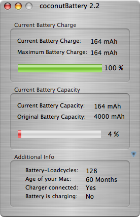

That's exactly what my dead iBook battery does. Download coconutBattery and post a screenshot of what it shows.
Edit: Here's mine...notice that's capacity is down to 4%. I get no more than 10 minutes of battery life out of it.

From what you can see it's inacurate really sometimes. 2k months? If it's already 2k Months, my AppleCare would be gone wayyyy long time ago...
