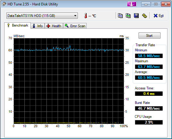

Me again. OK. So I've now done a full format on the SSD and it seems to be fast on the speedtest, but still seemingly about 20 Mbps slower than the internal drive. (see screenshots).
I note that the SSD seems more constant though, with 0.4ms access time, compared to the 17 Ms access time on the 5400 internal drive.
So based on these results, which drive should I use for my cubase audio stuff now?
Sorry, Im not up to speed on the technology, just looking for experienced advice. thanks again
Al
Al
Why don't you switch the drives? Put the SSD inside the MBP and put the 5400 HDD in the firewire enclosure. You'll get the speed and still have storage. www.ifixit.com has instructions on how to open stuff up. It should be very easy to do. P.S. You'll just have to switch the data on the drives too, so you have your OS on the SSD and storage stuff on the HDD.
Well thanks very much for that valuable experience. I know much more than I did yesterday!
OK so I've opted to install my SSD in the macbook and reformatted it with 10.6.6. Mac OS. (instead of running windows 7).
I've installed Cubase 6 and all my plugins and I'm totally stunned (in a good way) at the performance. Im running several CPU hungry VST instruments, with only 8% on the CPU meter!! Incredible!
I've just ran a hard drive speed test and average is about 255Mbps! OK so I've only got about 65Gb left on the drive, however, that's way plenty for my cubase projects. By the time I need more storage I expect SSD 512Gb drives will have plumetted in price so I'll upgrade and swap over the drives then. I can easily work with what I have for now, very happy! 🙂
Thanks for the advice everyone, I really appreciate it.
