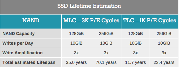

I agree with your overall point, but your numbers are a bit outdated. Even "high end" SSDs now only use MLC NAND which has 3,000-5,000 write cycles. Many of the newer SSDs (like Samsung 840 non-Pro) use TLC NAND with only 1,000 write cycles.
Really good article here showing even with a TLC NAND drive at 10GB a day, it will last over 11 years.
So back to your point, yes... just use your SSD and don't sweat it. It will likely outlast the rest of your computer.
