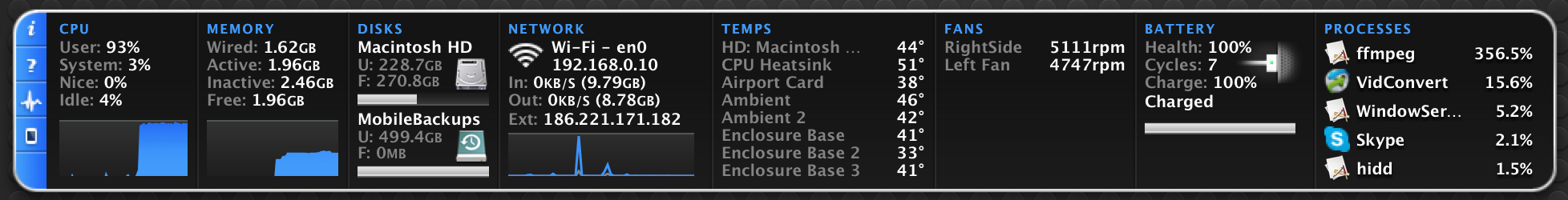

CPU has cooled down a bit now and the CPU Heatsink is showing 51° C. I intend to use my laptop for 4-5 years if possible. But that won't be constantly converting videos, and my CPU Heatsink temperature is usually around 40° C.
Here's a picture of iStat running in dashboard.

Those temperatures are actually really low. I've seen my rMBP get up to 100ºC on several occasions whilst completely maxing the CPU.
When temperatures get too hot, the fans obviously spin faster, the CPU can throttle itself down (reduce its clock speed to prevent overheating if the fans can't keep up), and the computer will also switch itself off in the rare event that temperatures really get dangerous, as others have mentioned.

Your temps are quite normal.
The Intel processors used in Macs are designed to automatically shut down to prevent damage if they truly overheat. CPU Tjmax = 105C (221F), GPU Tjmax = 100C (212F) on i3, i5, i7 processors. (Source: Intel)
