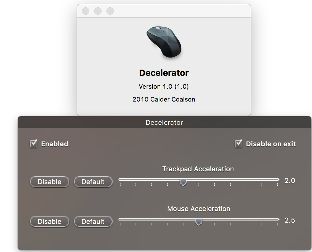

I also like to be able to adjust the acceleration. I used Decelerator for that:

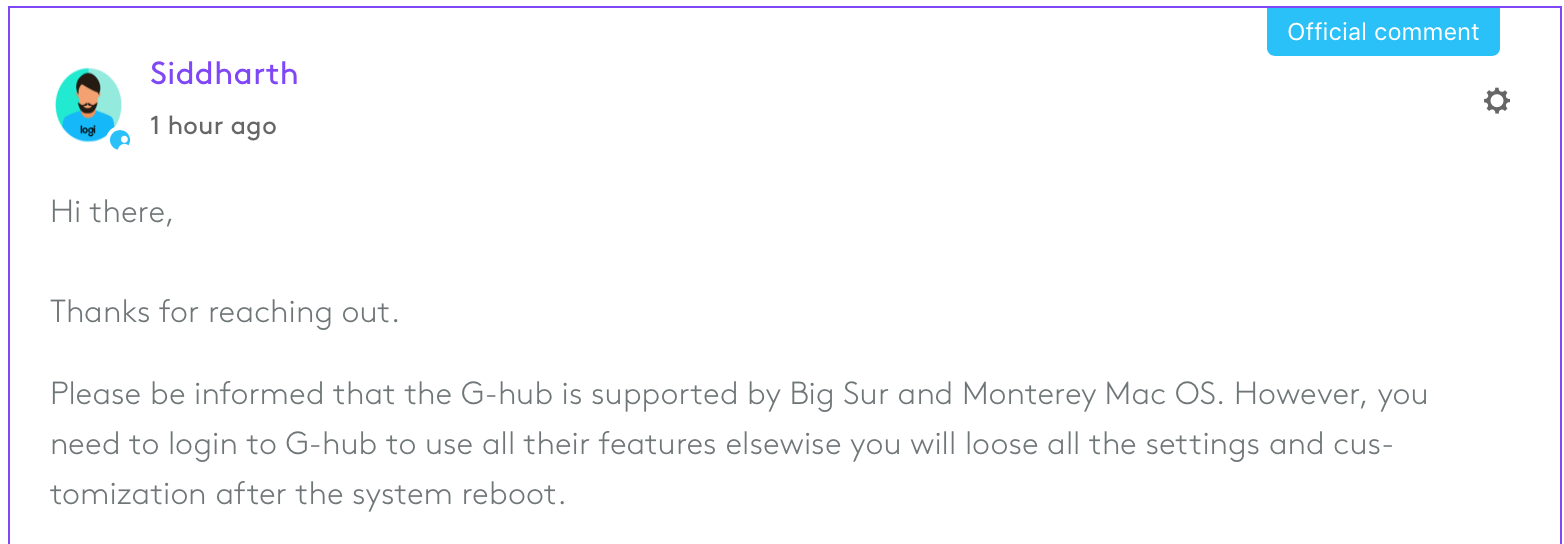

Also, I've read that, unlike with LGS, you need to login to G HUB each time you turn on your computer in order to use your customized profile.
Is this actually true? If yes, it would be obnoxious and intrusive, so I'm hoping the answer is no. For instance, I've seen videos showing that you can use G HUB to store memory profiles onboard your mouse itself. Maybe once you've done that you would no longer need to login to Logitech.

I’ve never had to login with an account to GHub. The software does need to be running to work though. It puts a icon in your menu bar.

Ah that's good. And I don't mind having to keep it running—that's what I currently do with LGS.
But I am confused. Logitech's own support is saying you do need to login:
