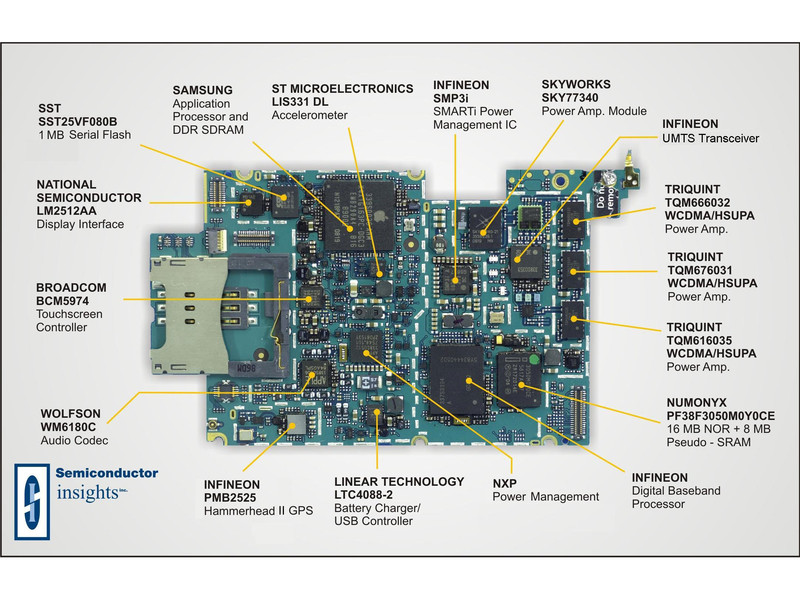

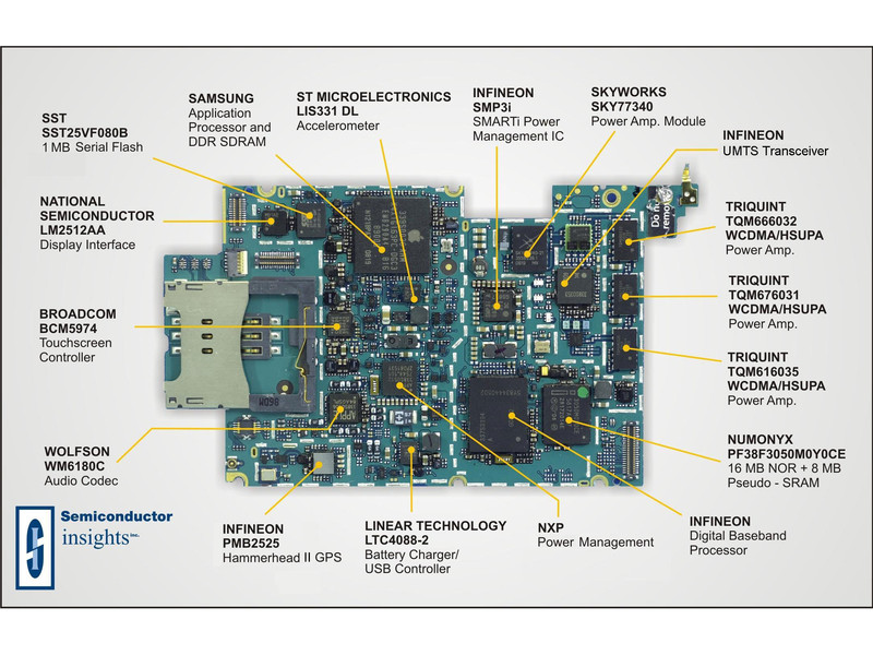

The phone does have actual gps, its a hamerhead gps II chip,
