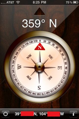

You apparently are not familiar with the Compass APP:
Lat and Lon can be displayed at the bottom.

Just because the app is called compass, doesn't mean that it's getting Lat and Lon from the compass...
A compass tells you your heading in relation to the magnetic poles. It doesn't have any idea where you are on the surface of the Earth.
My comment was to the poster who said you can't get lat and lon from A compass...but we were not talking about just A compass, but the Compass App which displays lat and lon values on the bottom, derived from GPS.
Of course you can't get lat and lon from a compass. GEEZ.
