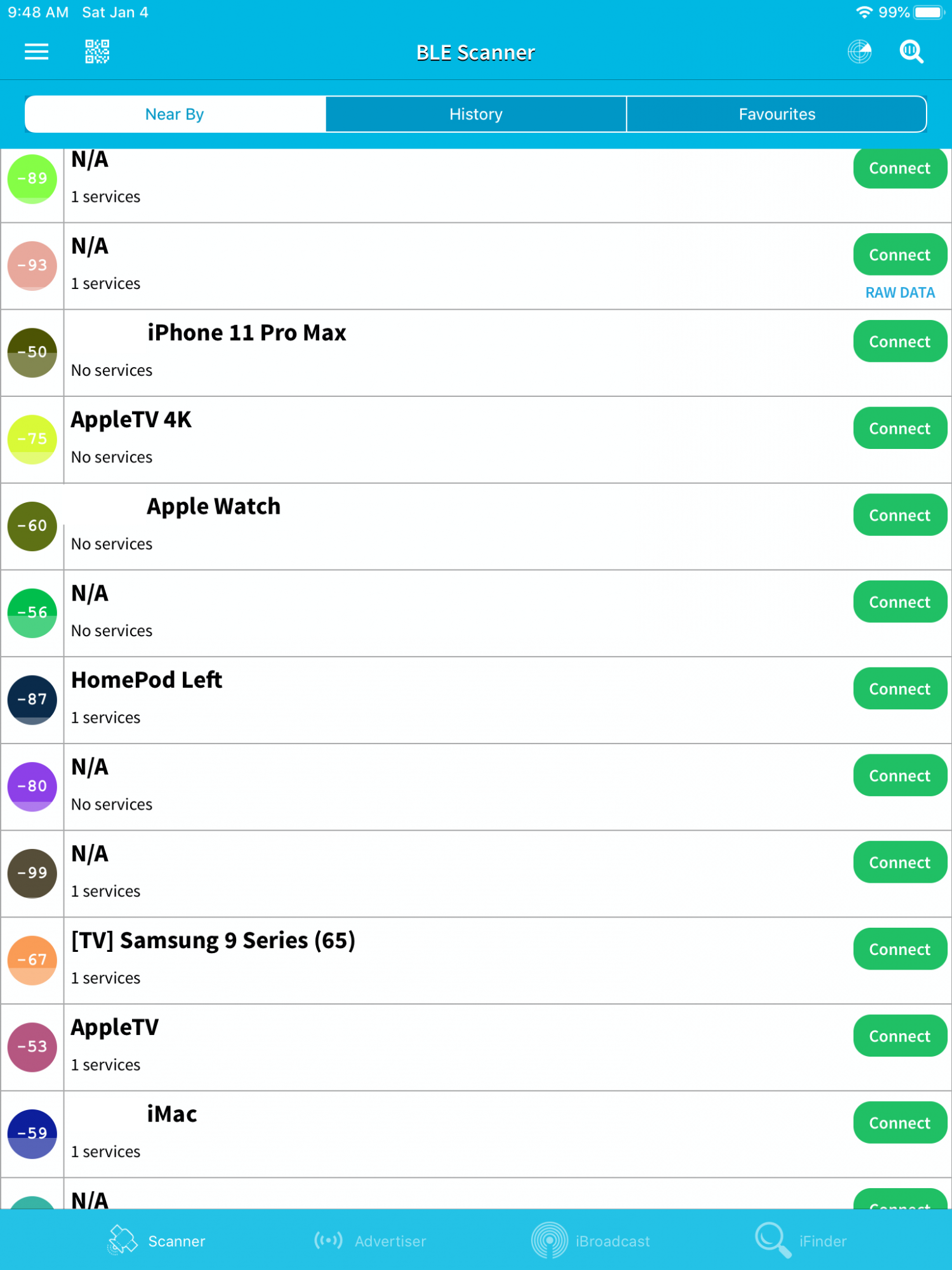

Keep in mind, bluetooth is always in use on the iPhone (and other smartphones). If you sniff for bluetooth you'll find the iPhone polling the area. Apple uses bluetooth for many features and functions such as AirDrop, Handoff for the HomePod, Instant Hotspot, Find My.., Siri suggestions, etc etc...

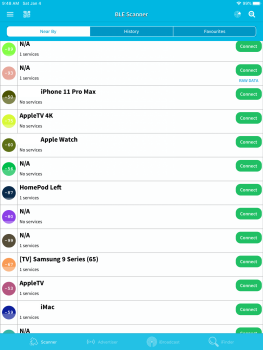

This is a screen shot from my iPad using a Bluetooth LE scanner. I live in a condo so many of these devices aren't mine.
(click image)
There are even situation that BT is saving you energy. A notable example would be significant location change data without using the actual GPS receiver. As a method to converse energy the iPhone can use data of other devices the BT sees or connects to as an indicator that the iPhones location has changed. Once that is determined apps and features that need general location data can utilize the GPS if needed. BT saved energy because the GPS wasn't activated just to "check" location, it was activated because the iPhone knew there was a location change from BT data.
When BT is actively doing something such as streaming music the processing of app data and screen usage will have MUCH higher energy usage then the BT radio.
If you need a real world example though, consider the Apple Watch. I can go about 2 days with my AW before its battery dies. In that time I'm receiving/responding to text, checking the weather, heart rate, its vibrating when I get a phone calls, change music via the on screen player, using HomeKit and Hey Siri etc etc etc. That is done via a persistent BT connection to the iPhone. So 2 days ~48 hours of constant bluetooth use with a battery that is ~10x (average) smaller then the battery in your iPhone.
TL;DR , its recommended to leave it on due to Apples heavy use of bluetooth for many features/function and as a method to reduce usage of hardware that is more energy hungry. Actual power usage when its on is virtually impossible to track due to the disparity compared to things that use considerable amounts of power like the screen.
