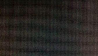

I took a picture of the pinstripes I was referring to, over a dark background. My monitor has not 'freaked out' since I created the thread, though it has consistently been displaying these pinstripes — sometimes a diminished version, but typically at the intensity shown.
