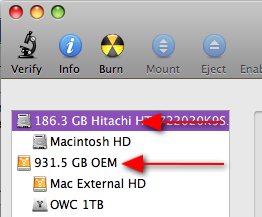

Ok I bought my 24" inch intel 2 duo iMac stock. In disk utility my main drive says it can not be repaired but the indented "Macintosh HD" says it's fine. Is the Mac hd just a partition? I don't get how the main drive is dead but the drive inside the main one is still fine? Please help, thanks.
The physical drives are indicated by arrows. The indented drives are partitions within the physical drives, also known as mount points. You don't mount a physical drive, you mount the logical drives, or partitions.
