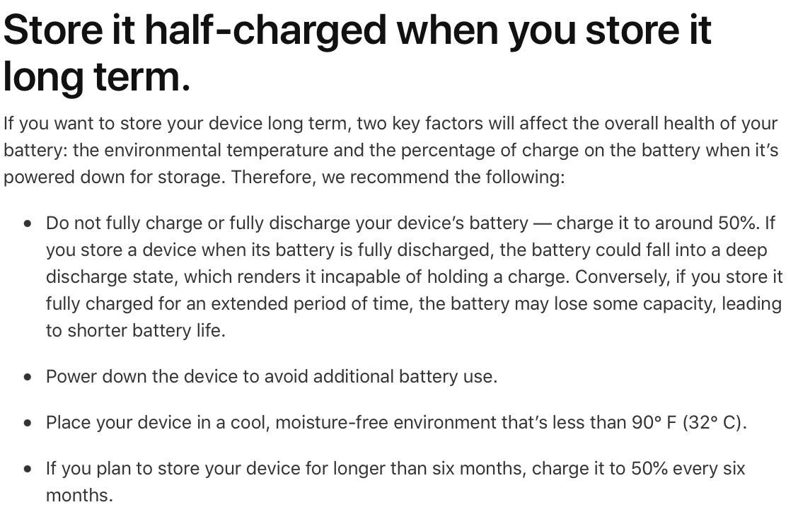

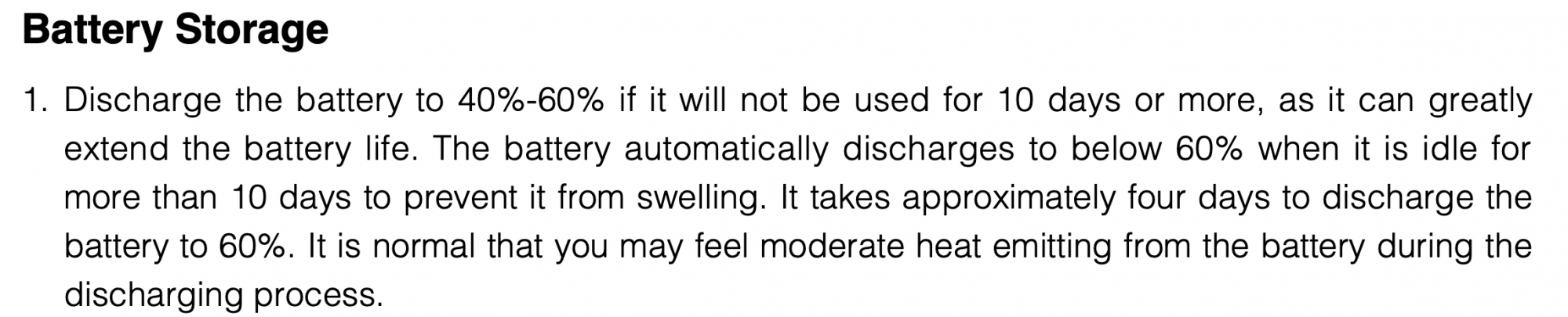

This doesn't tell the whole story. Also, what is true for one type of battery (like Ni-Cad) can be the opposite for another type of battery (like Li-ion).
If a Li-ion battery is maintained at 100% charge it will degrade.
The best way to preserve a Li-ion battery long-term is store it at 50% charge and keep it cold.
DJI "intelligent" drone battery packs automatically self-discharge to ~50% after 10 days of non-use, to self-preserve (without even being attached to a drone).
From Apple:
From DJI:
