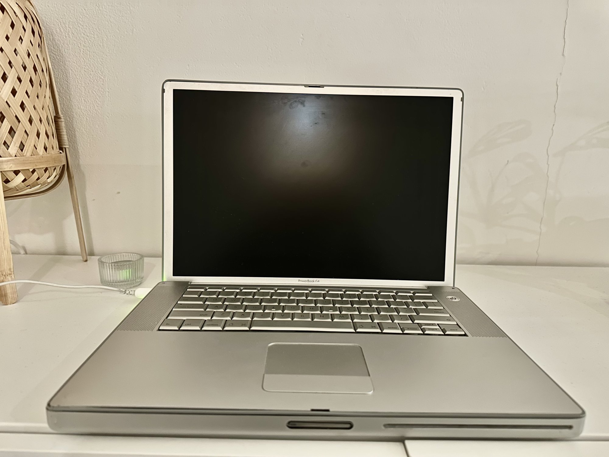

Hey guys i got a 15 inch g4 yesterday and it worked perfectly at the seller's house, but doesn't show any sign of life now at home. Can someone try and power a g4 15 inch with no battery and a A1036 45watt adapter? I tested it with a 65 watt at the seller that's the only variable i can think of.

My laptop is a A1138. It came originally with a 65w adapter. It hasn't damaged my 45w adapter because it power up my ibook fine after many attempts at using my powerbook 15 inch. But i don't have a 65 adapter to test if there's a problem with my g4 powerbook. I'd appreciate it if you can test sunday.

I just confirmed that this laptop will not power on with a 45-watt power adapter and no battery and that it powers on just fine with a 65-watt adapter and no battery.

Thank you very much for testing.🍻 You relieved my anxiety while I wait for an adapter. Because I live in Europe, vintage apple products are rare and I order abroad and wait long often.
