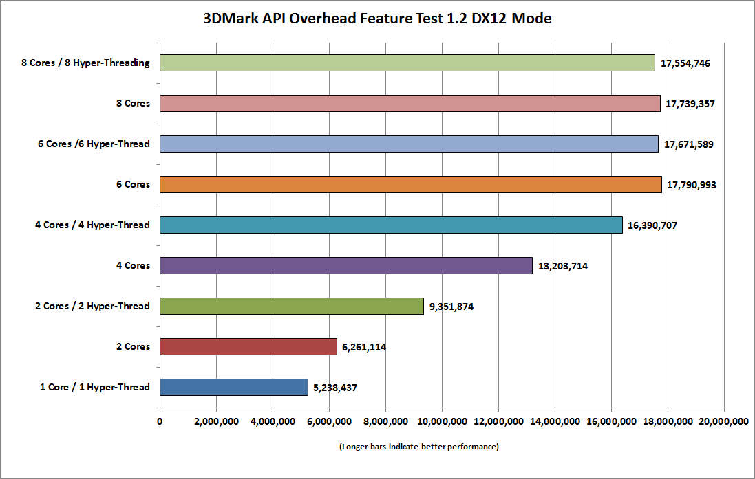

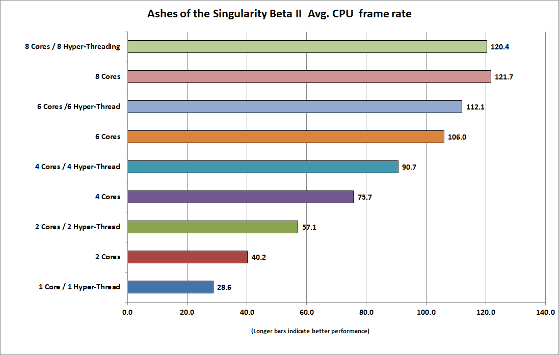

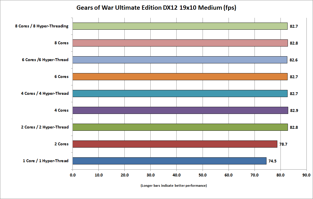

Sometimes there's a hard quadcore-only lockout (Dragon Age Inquisition for example) due to needing 4 cores because of how the engine works, but these will often be fooled by dual core with hyperthreading.
Also some games are just plain CPU intensive, regardless of GPU.
Depends on the game and API, some anything above 2 cores does nothing. Others 2 cores are crippling the performance a lot.
