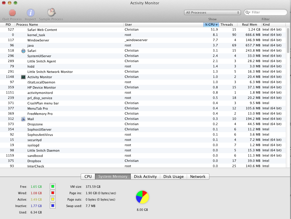

I've had this prior to this SSD. Before this Samsung, I had a Crucial m4. And I've already taken account the increase in activity during the beach ball. In the Activity Monitor however, "java" and "web process" takes a lot of CPU. Both seem to struggle for it, but java always get the most. I don't know what this is since I've already turned off java in my safari security settings.

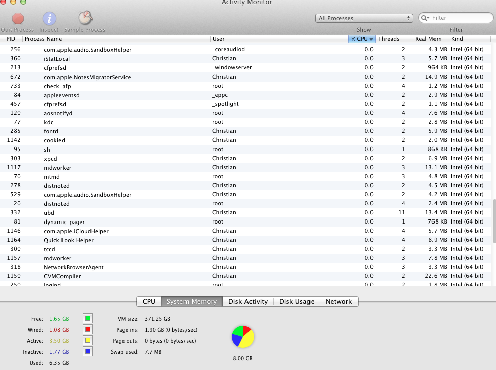

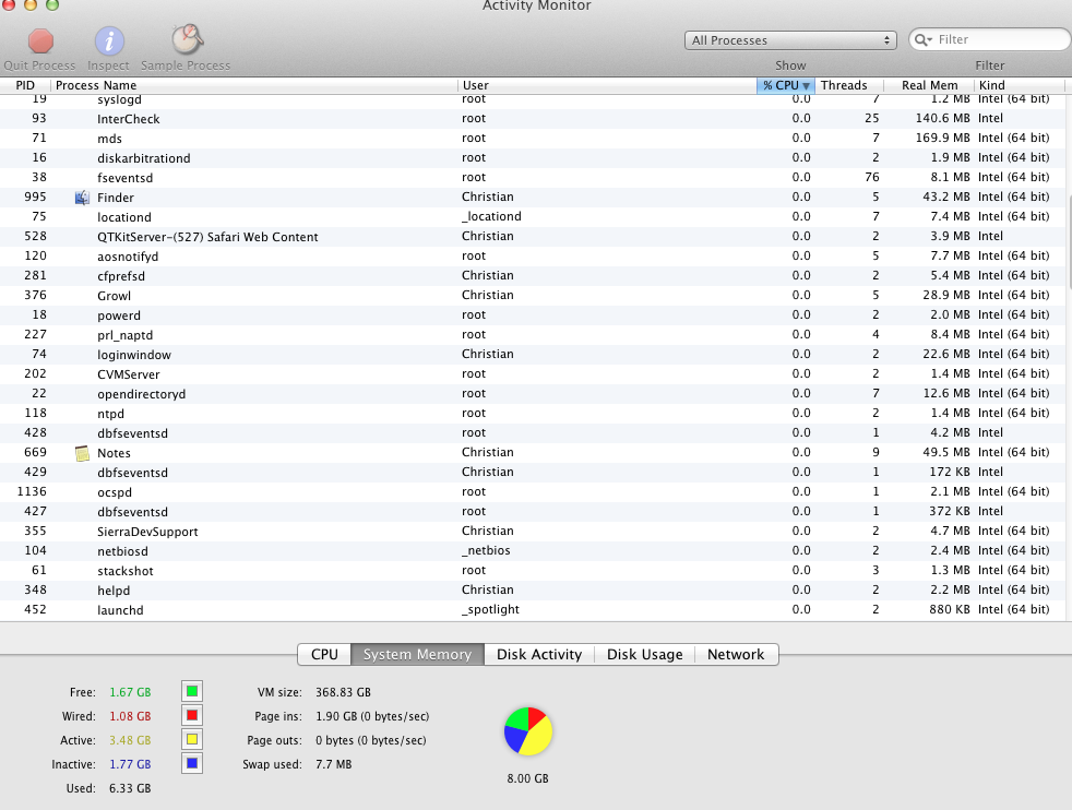

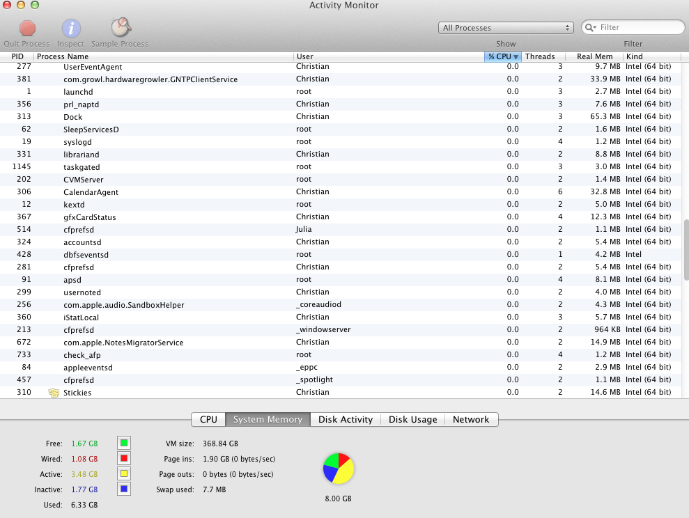

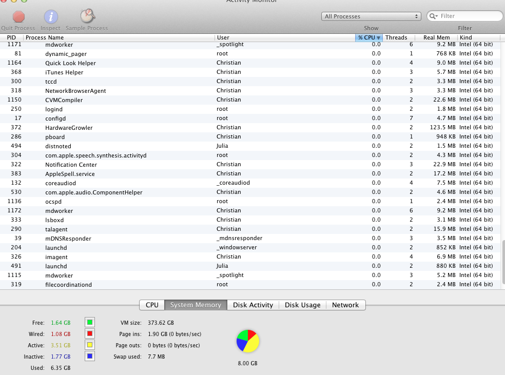

I think I did this right. Odd thing is that when I start doing the screen shot, the cursor was extremely sluggish but as soon as it was done it returned to normal.
Seems like I have open? I have Safari, Mail, iTunes, Notes, Stickies open. Menutab utilities: dropbox, drop zone, crash plan pro, sophos av, Facebook tab, growl, growl hardware, free memory pro, air parrot, gfx card, insomiax, istats pro.
I tried to get them all in each shot
Yep, you got the screen shots right. I have several observations.
  • I recommend that you avoid using Sophos, as it could actually increase your Mac's vulnerability, as described here and here. You don't need any 3rd party antivirus app to keep a Mac malware-free, as long as you practice safe computing, as described in the following link.
    Mac Virus/Malware FAQ
  • For the purposes of testing, shut down or uninstall Little Snitch and FreeMemory Pro. Also, disable your Safari extensions, except ClickToFlash. If you don't have that, get it.
  • Flash is notorious for consuming system resources, raising temps and decreasing battery life. For Flash-related issues:
    • Find your Flash version and make sure it's the latest version available. Never install or update Flash from a pop-up on a website. Always go to Adobe's site to get Flash or updates.
    • Install ClickToFlash (Safari), Flashblock (Firefox) or FlashBlock (Chrome) to control which Flash content plays on websites.
    • Try using the YouTube HTML5 Video Player to watch YouTube videos, when available. (May impact fullscreen viewing. See link for details.) Some have reported better performance with HTML5, while some have reported worse. Try it and find out what works best for you.
See how those changes affect performance.
What's the reason for these 2 apps? Since they happen to be my most useful apps.
You don't need FreeMemory Pro at all. Mac OS X manages memory automatically, without the need for interference by the user or 3rd party apps. Little Snitch is a good app for specific uses, but it's not necessary to keep your Mac running well or secure. It can add to overhead, impacting performance of apps.
