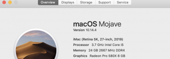

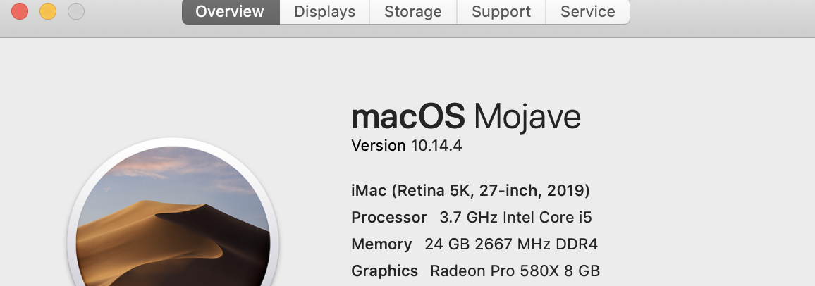

I just upgraded the RAM in my 27 Inch 2019 iMac, Putting the screen face down was not an issue and was straight forward. iMac recognized the Ram and shows total RAM of 24GB now. Purchased 2 x 8gb sticks for a total of 117$ from OWC
